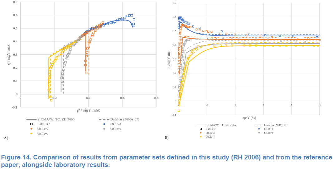

This example demonstrates how to parameterize the SANICLAY constitutive model from laboratory data. The parameters are then used in numerical simulations of the laboratory tests and the simulated results are compared with the reference paper and the measured data.
