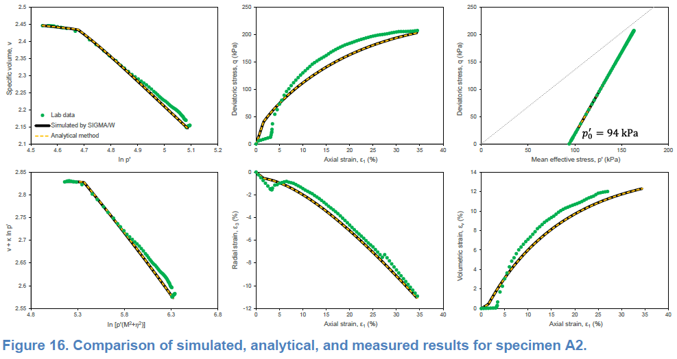

This example demonstrates how to parameterize the modified Cam clay constitutive model from laboratory data. The parameters are then used in numerical simulations of the laboratory  tests and the simulated results are compared with the measured data and analytical solutions.
