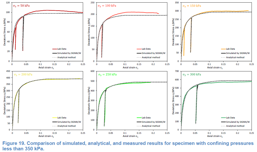

This example demonstrates how to parameterize the Hardening Soil constitutive model from laboratory data. The parameters are then used in numerical simulations of the laboratory tests and the simulated results are compared with the measured data and analytical solutions.
