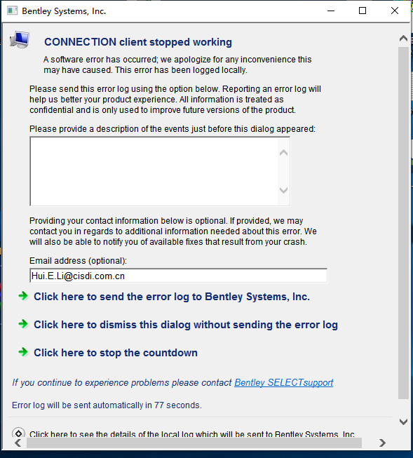

问题描述:
Connection Client升级后无法启动并弹出以下错误:Connection Client stopped working.
A screenshot of a computer error messageAI-generated content may be incorrect.

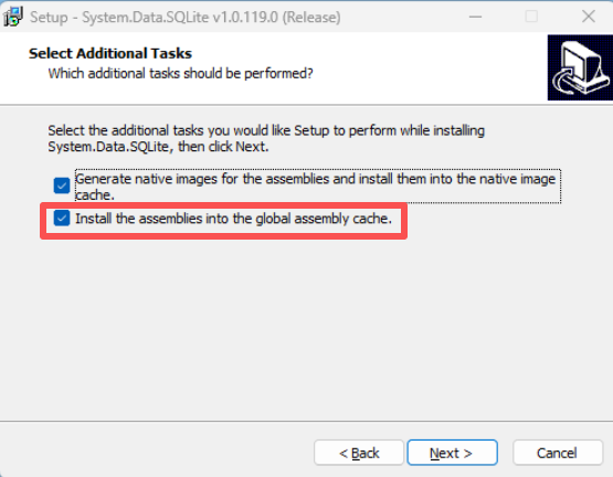

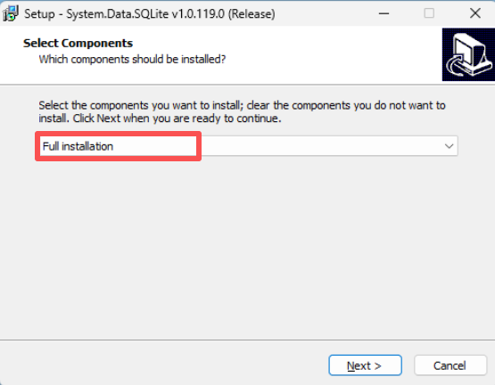

解决方法:
需要重新安装System.Data.SQLite
