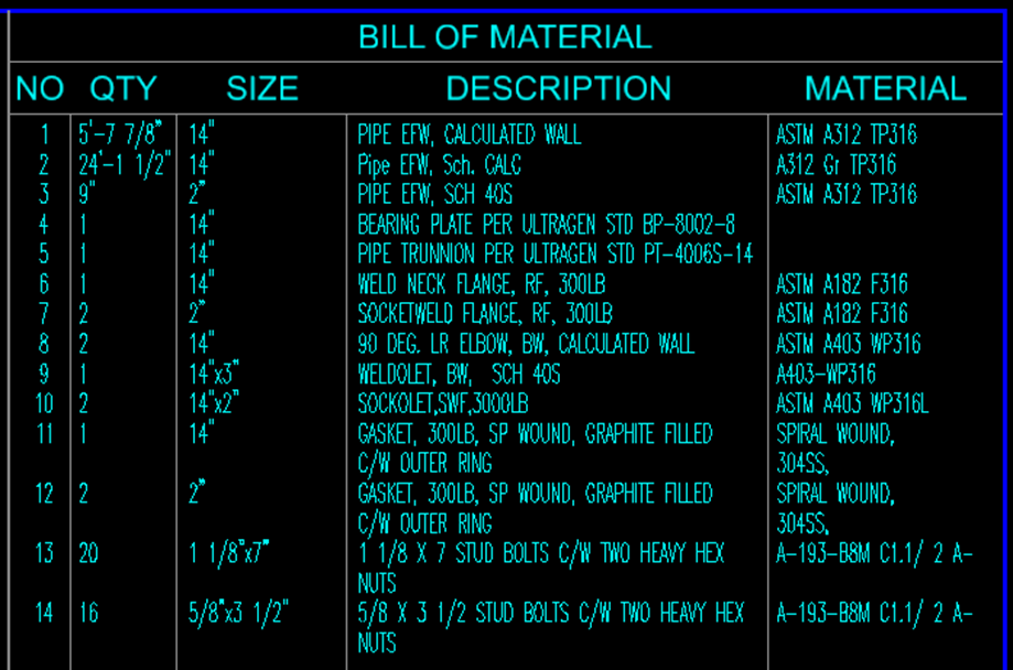

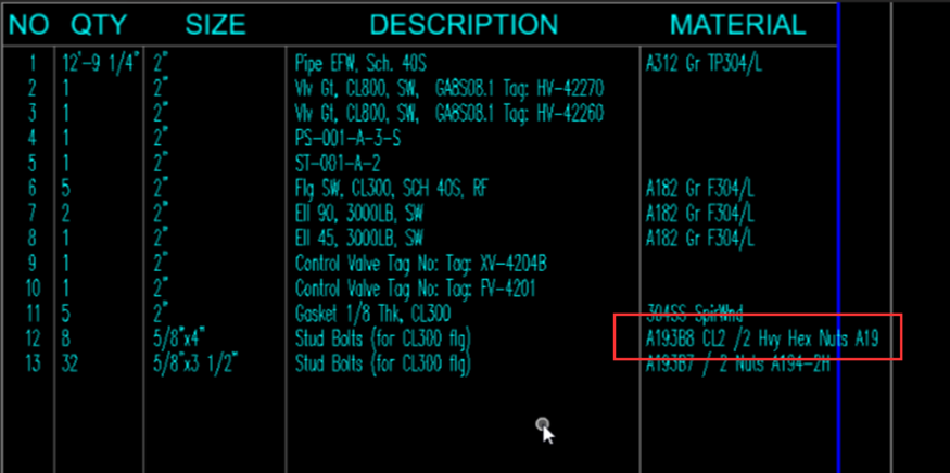

In OpenPlant Isometrics Manager, the user has an issue where certain texts are overlapping in the frame or template of Bill of Materials.

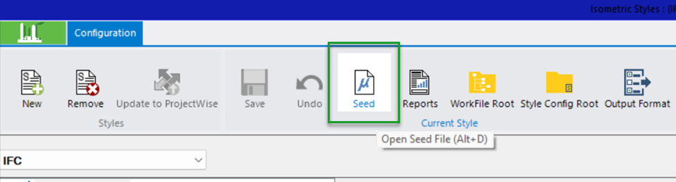

1. Open the seed file in Isometric Configuration.

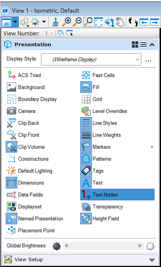

2. Enable Text Nodes in View Attributes.

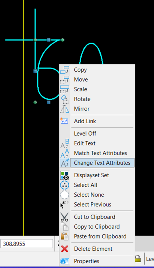

3. In the area of Bill of Materials, select and right click the text node. Choose Change Text Attributes.

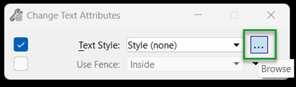

4. Select Browse at the right most side.
5. Change the font style to INTL_ISO_EQUAL or Romans.
