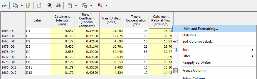

If you do not wish to do this and want to use the 1.0 factor, then you will need to change to the correct flow units of acre-in/hr. On a Catchment Flex Table change the units as shown below it you do not want to see the 1.008 conversion value, but the value in in-ac/hr:
Display Precision
When comparing results to hand calculations, also be aware that the software displays values that are rounded based on display precision (the number of significant digits after the decimal).
For example, a value of 1.23456789 would display as 1.23 at a precision of 2, or as 1.234568 at a precision of 6. Either way, the underlying value is still stored at the highest possible precision.
To change the display precision, just right-click on the field with the value of interest and select Units and Formatting from the context menu.
