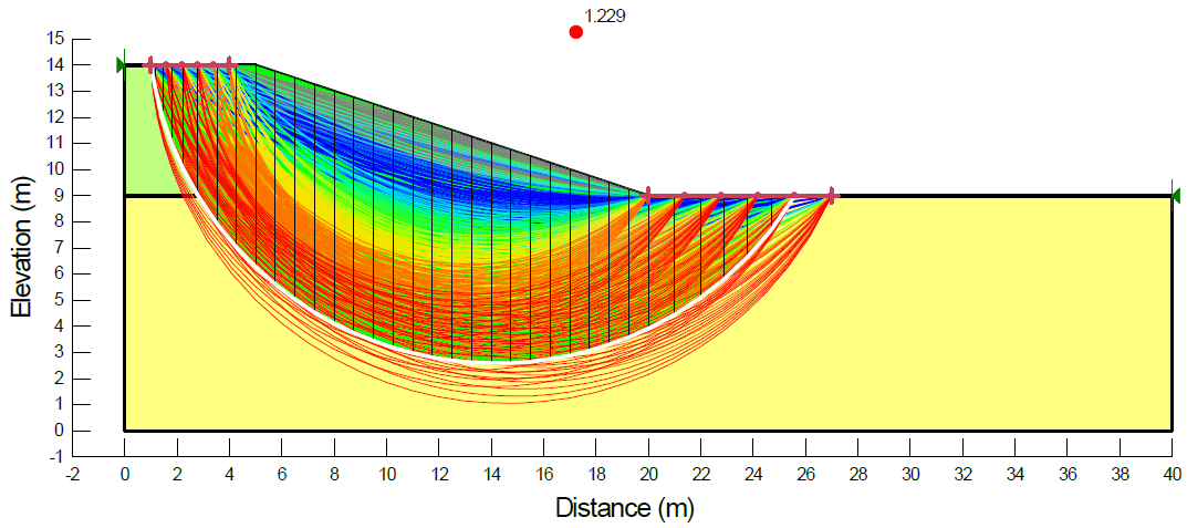

Embankment on Geosynthetic
Application GeoStudio
Version Latest version
Primary Analysis SIGMA/W
Keywords GeoStudio, SIGMA/W, embankment, geosynthetic, deformation, reinforcement
Introduction
This example demonstrates how a geosynthetic can be included as reinforcement in the staged construction of an embankment on soft ground. The amount of load transferred into the geosynthetic is evaluated along with the deformation pattern caused by construction.
