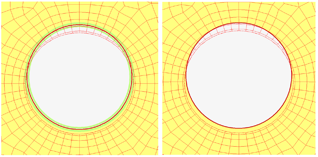

This example demonstrates how SIGMA/W can be used to model a structural liner on a circular opening by using a beam applied to the surface of the opening. In addition, the example illustrates how to consider the possibility of slip between the structural liner and the surrounding soil.
