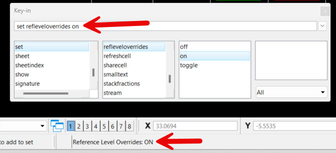

    Reference level override settings
    Level of reference have been turned off, if the file is closed and re-open the level will be turned back on. If this occurs you first want to make sure that the reference file level overrides have been set to ON to allow this functionality in the master file. If you go to the key-in Window and type in: SET REFLEVELOVERRIDES ON, this will turn this setting on so that any override change for the reference file made in the master file will remain. You can check to see what the master file is currently set to by typing in: SET REFLEVELOVERRIDES and then selecting enter. The value will appear in the Message Center.
    If the level display in the attached reference is changed in the reference file, this will reflect in the master file.
    The reference level override setting allows you to keep or discard the overridden information. E.g., when this is set to OFF (Key-in: SET REFLEVELOVERRIDES OFF) in the master file; and in this changed state (global display is set to OFF for Reference Levels in the master file. If the file is closed and re-opened, then the changes will be restored back (Global Display is set back to 'ON'). And, if you set Reference file Level override setting to ON (Key-in: SET REFLEVELOVERRIDES ON), then any changes made to the property of reference levels in the master file will persist. You can verify the current state of this setting by Key-in: SET REFLEVELOVERRIDES. When executed, the current state appears in the Message Center (e.g., Reference Level Overrides: ON). Reference Level Override setting is set to ON by Default.

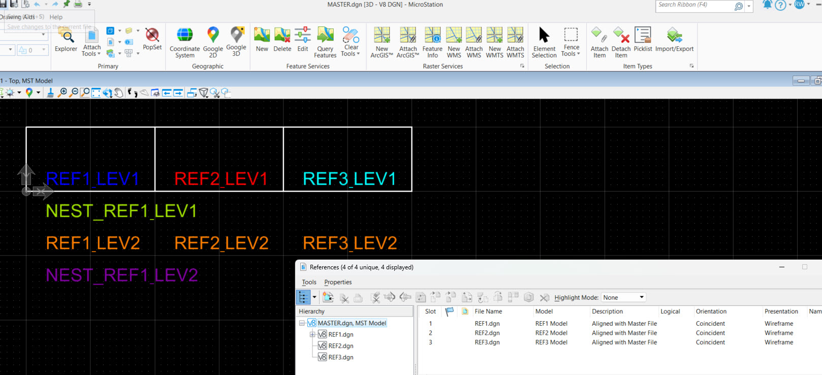

    When a MicroStation design file used as a reference has its own attachments, the files attached to the parent file become nested references. The links between these files can be maintained through many levels (depths) of nesting, so that if you open only one file, you can view the contents of many files.
    E.g., sheet models (Sheet1, Sheet2 and Sheet3 etc.) that are created in the MASTER.dgn has Reference attachment of the default model, while this model also has Reference attachment of 3 models from the external files (REF1.dgn, REF2.dgn and REF3.dgn) respectively. In this case these 3 models act as a nested reference of the sheet models.
    The significance of this is when this attachment is made the level display of the nested file cannot be controlled in the master file (File 3.dgn)

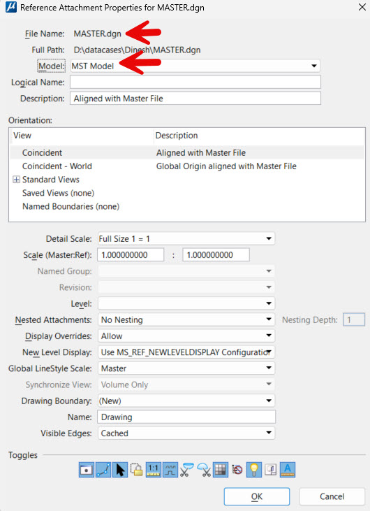

    To do this manually:
    Create the sheet model.
    Use the 'Attach Tool' to attach reference,

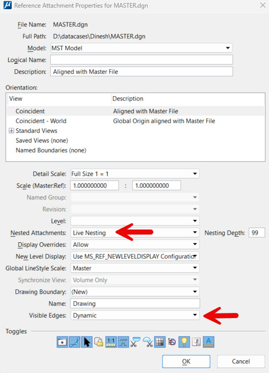

    Be sure to set the 'Nested Attachments' setting to 'Live Nesting and the 'Visible Edges' setting to 'Dynamic'

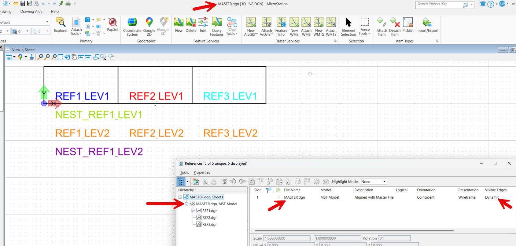

    This will bring in the default model and all the external reference attachments. The display will be same in the newly created sheet as in the default model. This process can be done multiple times for different sheets in the file.
    With 'Visible Edges' set to dynamic, allows for the propagation of level mask (on/off) display to be carried from the default model to the sheet(s).
    Go to the default model and turn off the global display of a level e.g., "REF1_LEV1" the same level will be turned off in the sheet. This is done the level synchronization.
    The same thing can be done with level symbology and override setting can also be carried through. As long as the changes are made from design model to sheet model the reference levels will stay in synchronization of each other.
