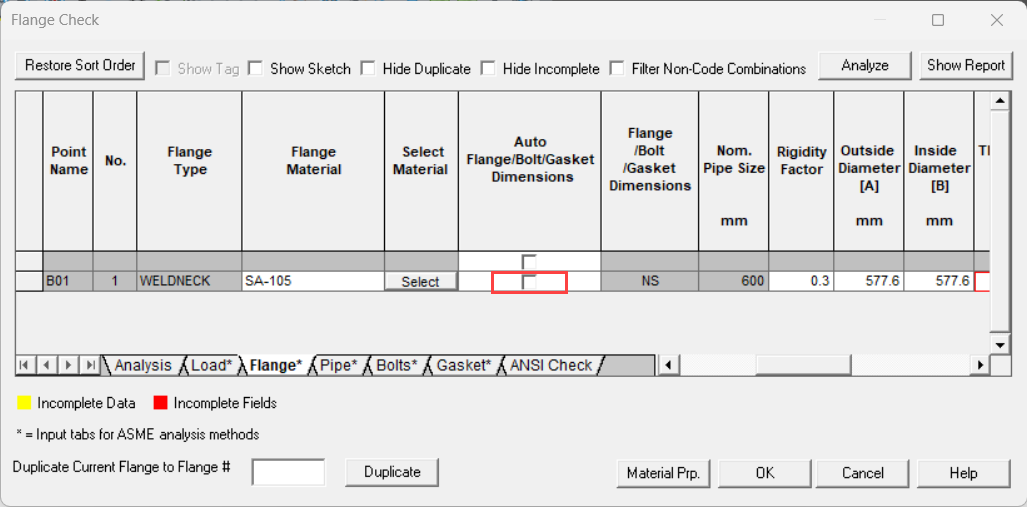

How can I input non-standard flange dimensions in the Flange Analysis module?
The flange dimensional parameters within the Flange Analysis module can be configured using the following approaches:
  1. Standard Library Defaults, dimensions are sourced from the FlangeDimLib.db file, which includes standardized data from codes such as ASME B16.5, EN, etc.
  2. User may manually define all flange, bolt, and gasket dimensions by deselecting the Auto Flange/Bolt/Gasket Dimensions option located in the Flange Check module under the Flange tab.
