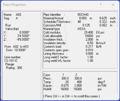

Original window size:

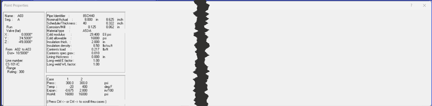

Wide window size:

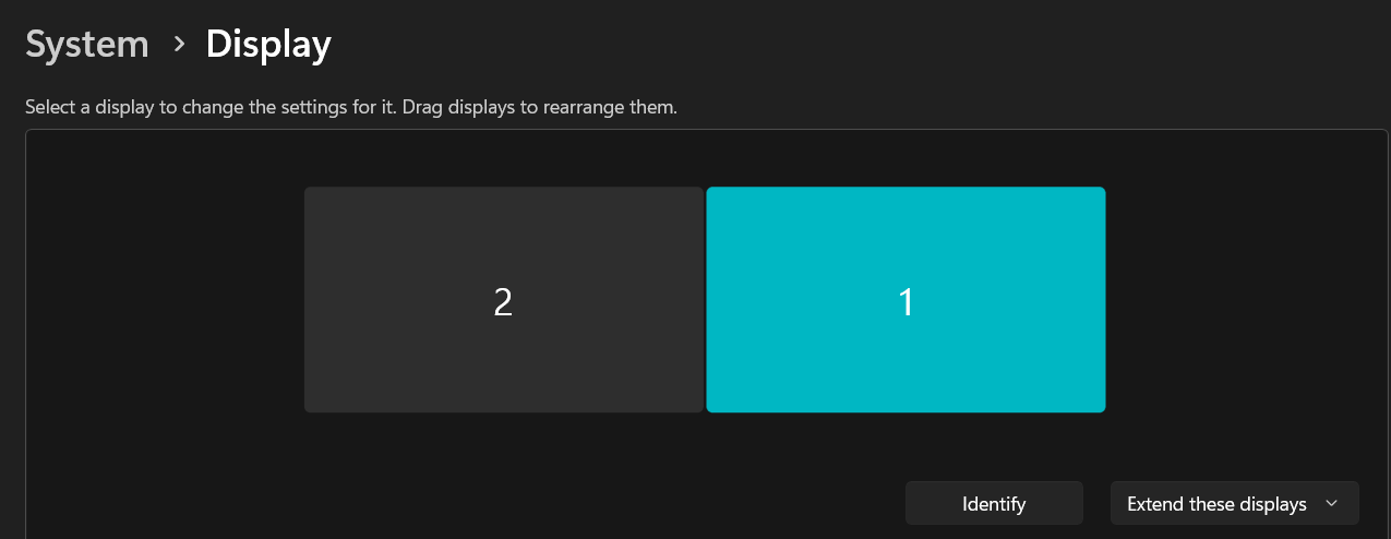

      5. Use mouse to click on the floating dialog and drag it over to be completely on screen #2.
      6. With floating dialog displayed on only screen #2, Close the floating dialog

      8. Notice the size of the floating dialog is much wider now.
