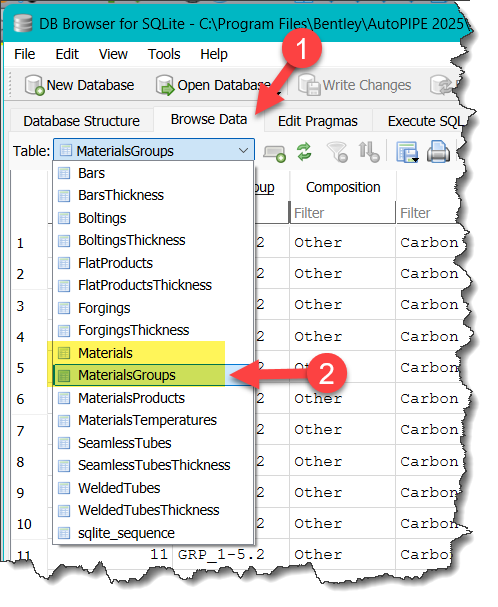

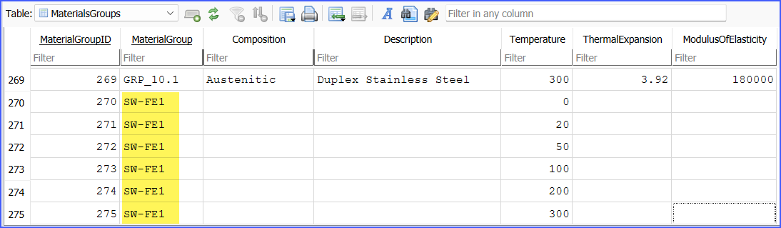

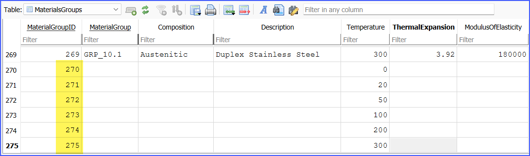

Step 1: Add New Material to the MaterialsGroups table
If you can see the "MaterialGroup" you want to use for adding the new material specification, you may skip this step. Otherwise, follow the steps below to add a new "MaterialGroup".
Example: Add “SW-FE1” Material Group
Steps:

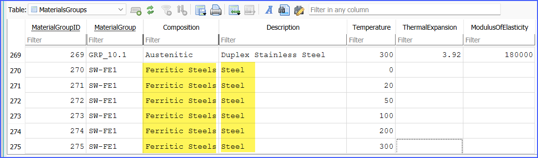

1. With MaterialsCatalog.db  opened, select the Browse Data tab, in the "Table" dropdown menu, and select MaterialsGroups.

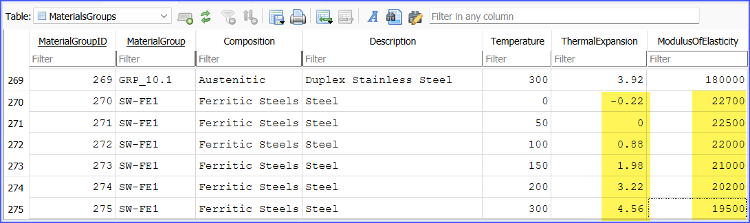

2. Determine the number of temperature ranges needed for the new material
a. For example, material with the following ranges:
b. This would count as 6 ranges, therefore, insert 6 new rows to the table.
3. Use Insert new records command(), add six records corresponding to the temperature ranges mentioned above.
4. Assign a unique MaterialGroupID to each of the new records. These IDs must not duplicate any existing IDs in the table (suggest using the row number).
5. For each new record, set the MaterialGroup field to “SW-FE1”.
6. In the Composition  and Description fields, enter “Ferritic Steels” and “Steel”, respectively.
7. For each record, enter the Thermal Expansion and Modulus of Elasticity corresponding with the Temperature.Ç
8. After completing all entries, click File> “Write Changes” (Cntl+S) to save your changes to the database.

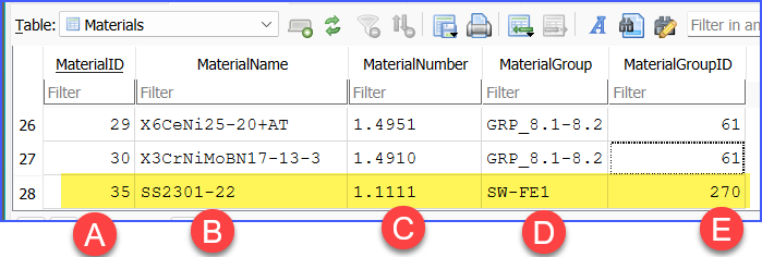

Step 2: Add New Material to the Materials table
Example: Add new material called “SS2301-22 “ and link to newly added “SW-FE1” Material Group from Step #1 above.
Steps:
1. With MaterialsCatalog.db  opened, select the Browse Data tab, In the "Table" dropdown menu, and select Materials.
2. Use Insert a new record command with the following details:
a. A unique MaterialID (make sure it does not duplicate an existing ID).
b. A MaterialName (e.g., SS2301-22).
c. A MaterialNumber as per your internal or standard numbering system. (e.g., 1.1111).
d. A valid MaterialGroup name — either one defined earlier (e.g., SW-FE1) or an existing entry already present in the MaterialGroups table.
e. The corresponding MaterialGroupID,  go to the MaterialsGroups table, scroll down to identify the ID used in the first record classifying the new “SW-FE1” MaterialGroup, from Step #1 (e.g., 270).
A screenshot of a computerAI-generated content may be incorrect.
3. After completing all entries, click File> “Write Changes” (Cntl+S) to save your changes to the database.

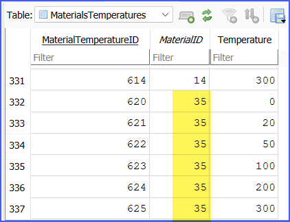

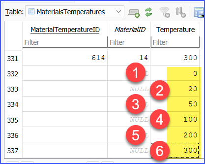

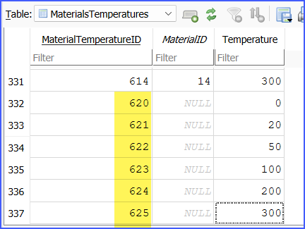

Step 3: Adding Temperature Range(s) for the Newly Added Material
For each new material name added to the Materials table, must define a temperature range that will be used to store temperature-dependent data.
Example: Add new temperature range for newly added material “SS2301-22 “ and link to the Materials table added in Step #2 above.
Steps:
1. With MaterialsCatalog.db  opened, complete steps above, select the Browse Data tab, In the "Table" dropdown menu, and select MaterialsTemperatures.
2. Determine the number of temperature ranges needed for the new material.
3. Assign a unique MaterialTemperatureID to each record and confirm no duplicate values.
4. Link each record to the relevant MaterialID defined earlier. Enter corresponding MaterialID matching to the new Material name. Go to the Materials table, scroll down to identify the new MaterialName and related Material ID (eg. SS2301-22  parallels 35)  from Step #3.
5. After completing all entries, click File> “Write Changes” (Cntl+S) to save your changes to the database.

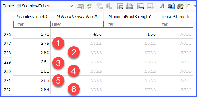

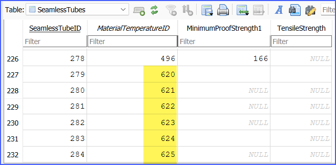

Step 4.1: Update SeamlessTube table:
Recalling this table is used for material data that is independent of thickness range.
Steps:
1. With MaterialsCatalog.db  opened, complete steps above, select the Browse Data tab, In the "Table" dropdown menu, and select SealessTubes.
2. Number of Records to be added into the table.
a. Must add one record for each new temperature range defined earlier in the MaterialTemperatures table (Step #3 above).
For example, 6 temperature ranges were added in Step #3, thus add 6 records to the SeamlessTubes table.
3.Update table with corresponding MaterialTemperatureID values for each new record added in Step #2 above.

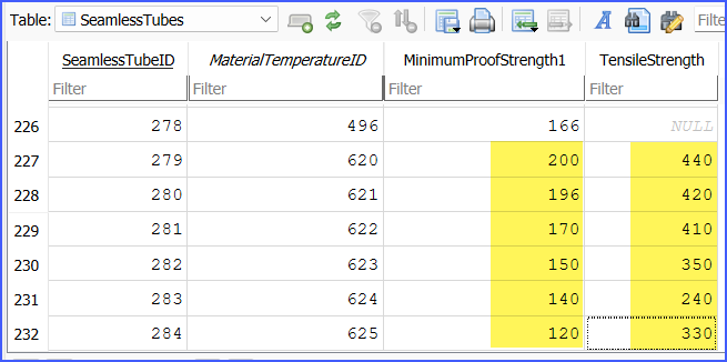

4. Update table with corresponding material data, MinimumProofStrength1, and TensilStrength.

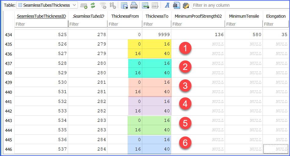

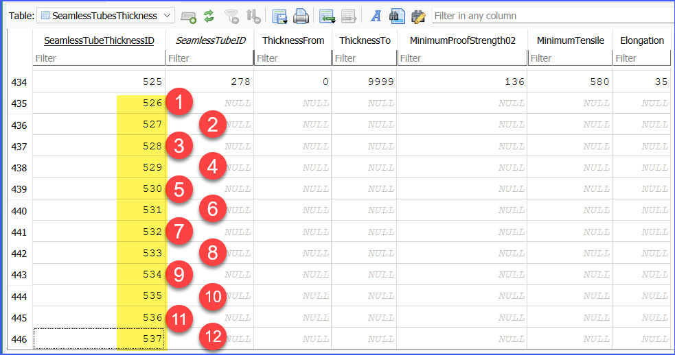

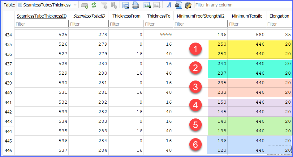

Step 4.2: Update SeamlessTubeThickness table:
Recall this table is used for material data that is dependent on thickness range.
Steps:
1. With MaterialsCatalog.db  opened, complete steps above, select the Browse Data tab, In the "Table" dropdown menu, and select SeamlessTubeThickness
a. Calculate A x B:
A = number of SeamlessTub records add in Step 4.1# above (eg. 6).
B = number of thickness ranges to be added. (note, from example information above 2 thickness ranges have been identified)
b. Number of Records to be added = A x B
c. 6 x 2 = add 12 new records to the SeamlessTubeThickness table.

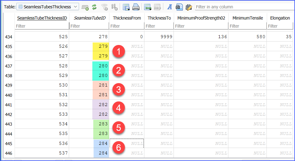

3. Update SeamlessTubeID column
a. For each newly created SeamlessTubeThicknessID, enter the appropriate SeamlessTubeID added in Step 4.1 above.
b. Since 2 thickness ranges have been identified, use the same SeamlessTubeID for two consecutive records (note, if 3 thickness ranges had been identified, then repeat SeamlessTubeID 3x).
c. This links both thickness entries to a single SeamlesstubeID and MaterialtemperatureID record.
4. Enter corresponding ThicknessFrom and ThicknessTo data for each SeamlessTubeID:
a. From Example information above, 2 thickness band ranges are:
5. Update table with corresponding material data, MinimumProofStrength02, MiniumuTensile, and Elongation.
6. After completing all entries, click File> “Write Changes” (Cntl+S) to save your changes to the database.

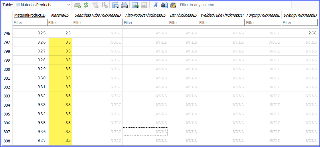

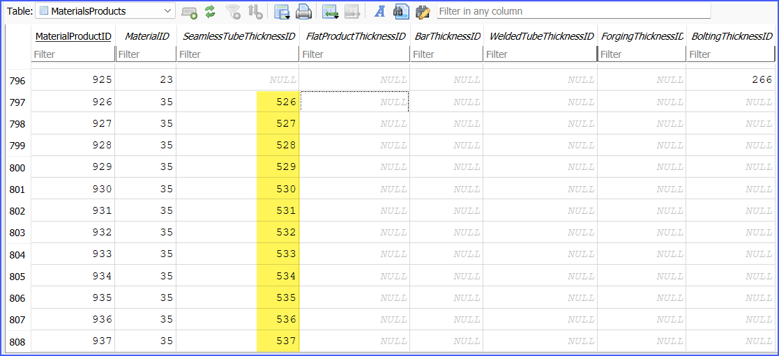

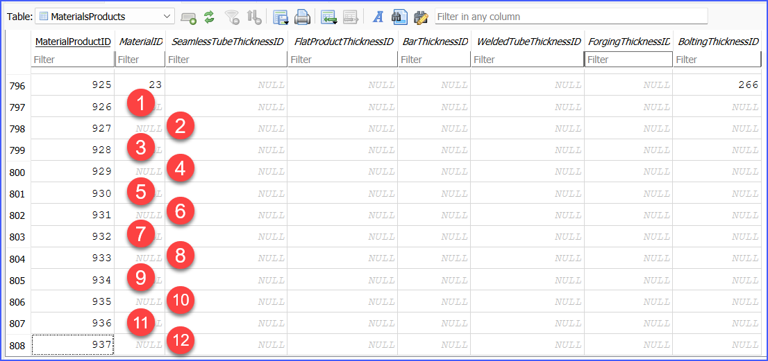

Step 5: Close the Loop, link SeamlessTubeThicknessID records to the MaterialID
To complete the setup and close the loop for the newly added material specification, must confirm that all data in the SeamlessTubeThickness table is correctly linked to the corresponding MaterialID created in Step 2.
Steps:
1. With MaterialsCatalog.db  opened, complete steps above, select the Browse Data tab, In the "Table" dropdown menu, and select MaterialProducts table
3. For each new record, enter the MaterialID that was generated in Step 2 for the material specification (e.g., MaterialID = 35 for SS2301-22).
4. Update SeamlessTubeThicknessID column,
5. This establishes the final mapping between:
