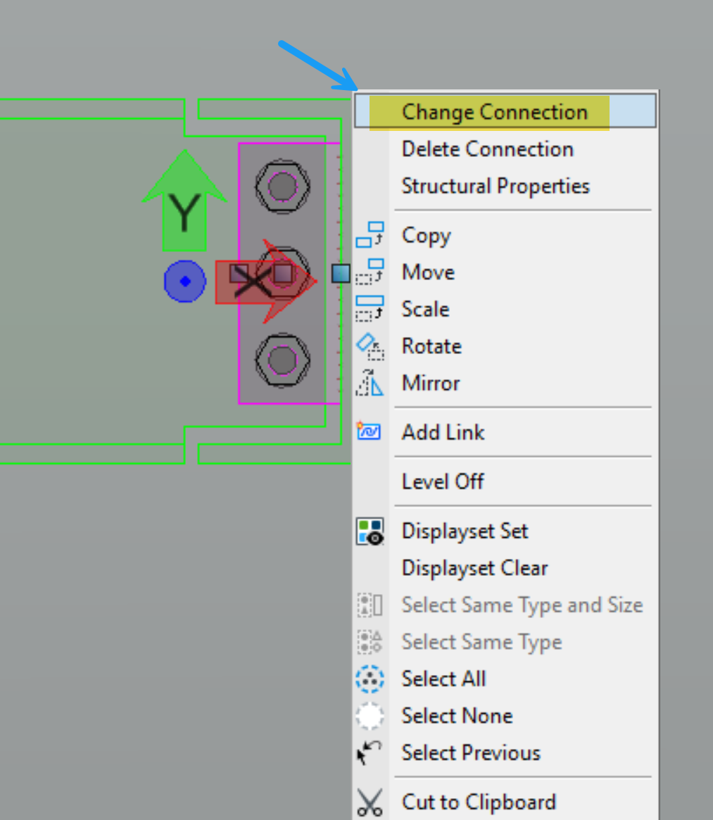

  1. To export or import connection templates in ProSteel, open the connection dialog either during placement or by right-clicking and selecting the "Change Connection" tab.

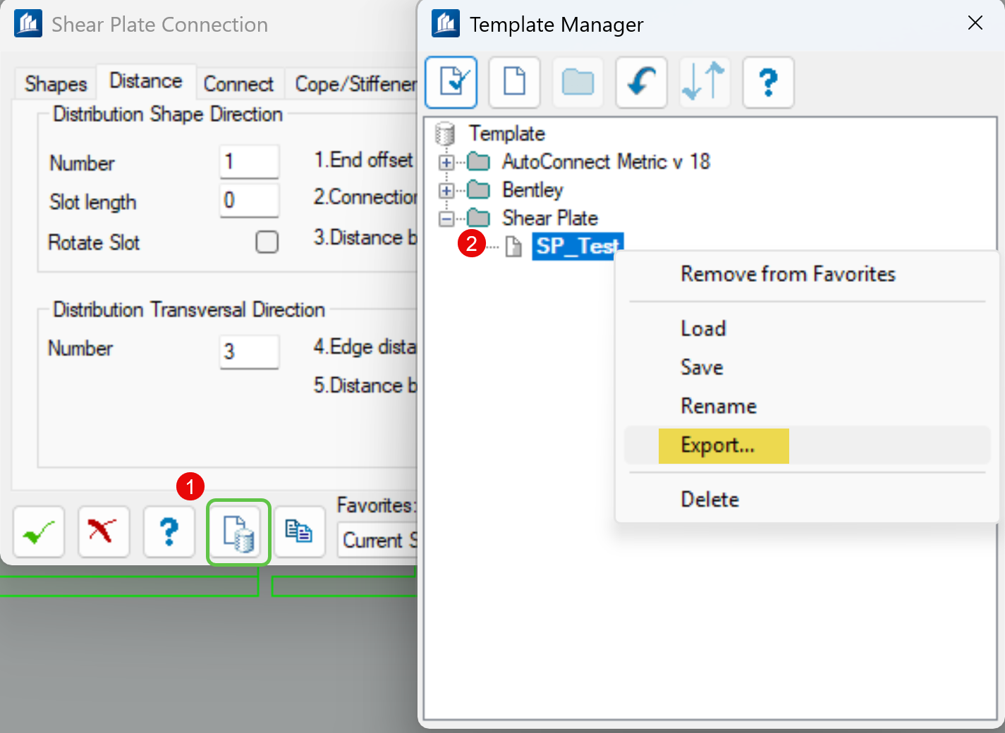

  1. Navigate to the Template tab to open the template window.
  2. To export a specific connection template, right-click on it and select "Export.
  3. You’ll be prompted to choose a location to save the exported template.
  4. To import a template, right-click on an empty area in the template window and select "Import.
  5. Click on Import and choose the template you want to import.
