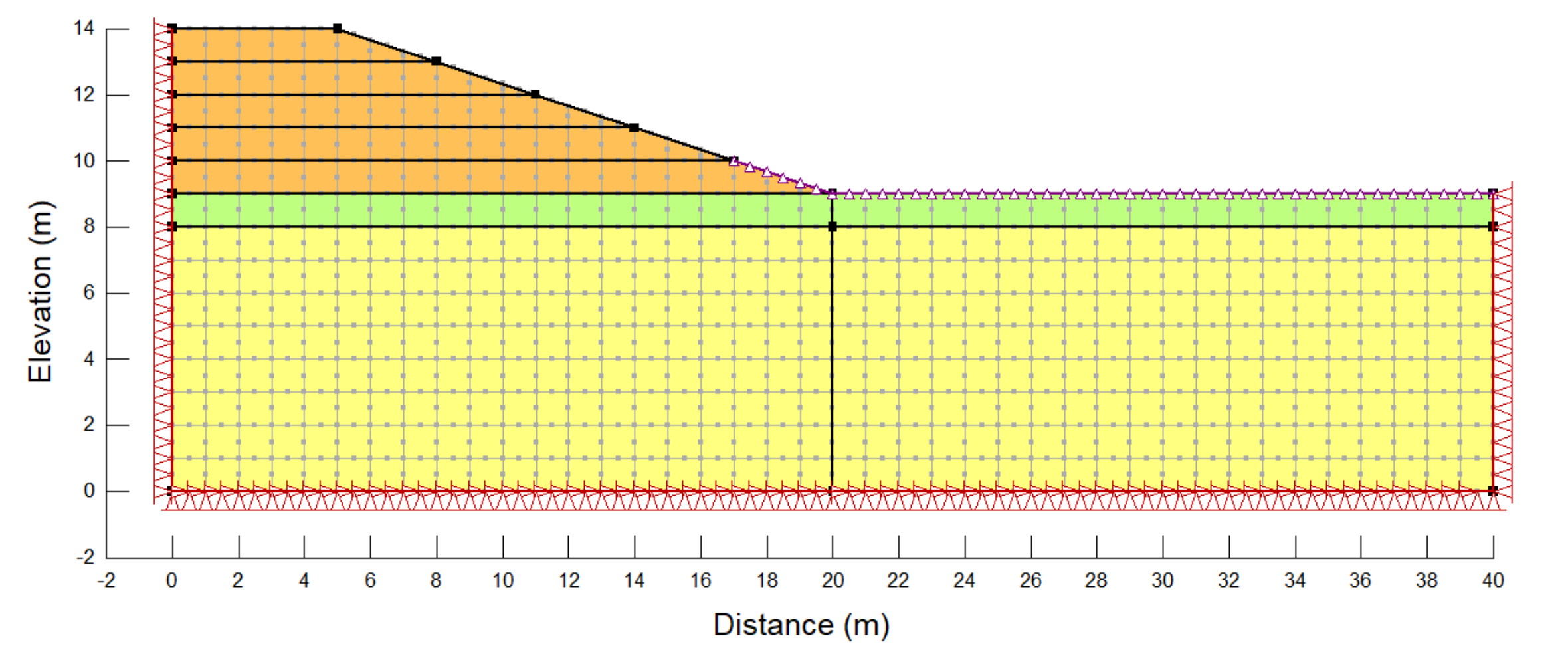

This example is about constructing an embankment in delayed stages on a soft foundation so that some of the excess pore-water pressure is allowed to dissipate before subsequent lifts are placed. The soft foundation is modeled using the non-linear Modified Cam-Clay (MCC) constitutive relationship.
