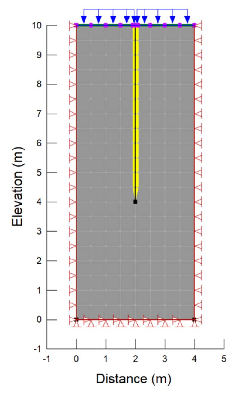

Consolidation with wick drain
Application GeoStudio
Version Latest version
Primary Analysis SIGMA/W
Keywords GeoStudio, SIGMA/W, Consolidation, Wick Drain
Introduction
This example is about modeling the behavior of a wick drain in a consolidation analysis. The primary purpose here is to illustrate how interface elements can conveniently be used to include the effects of a wick drain, and to discuss some of the analysis issues relevant to wick drains.
