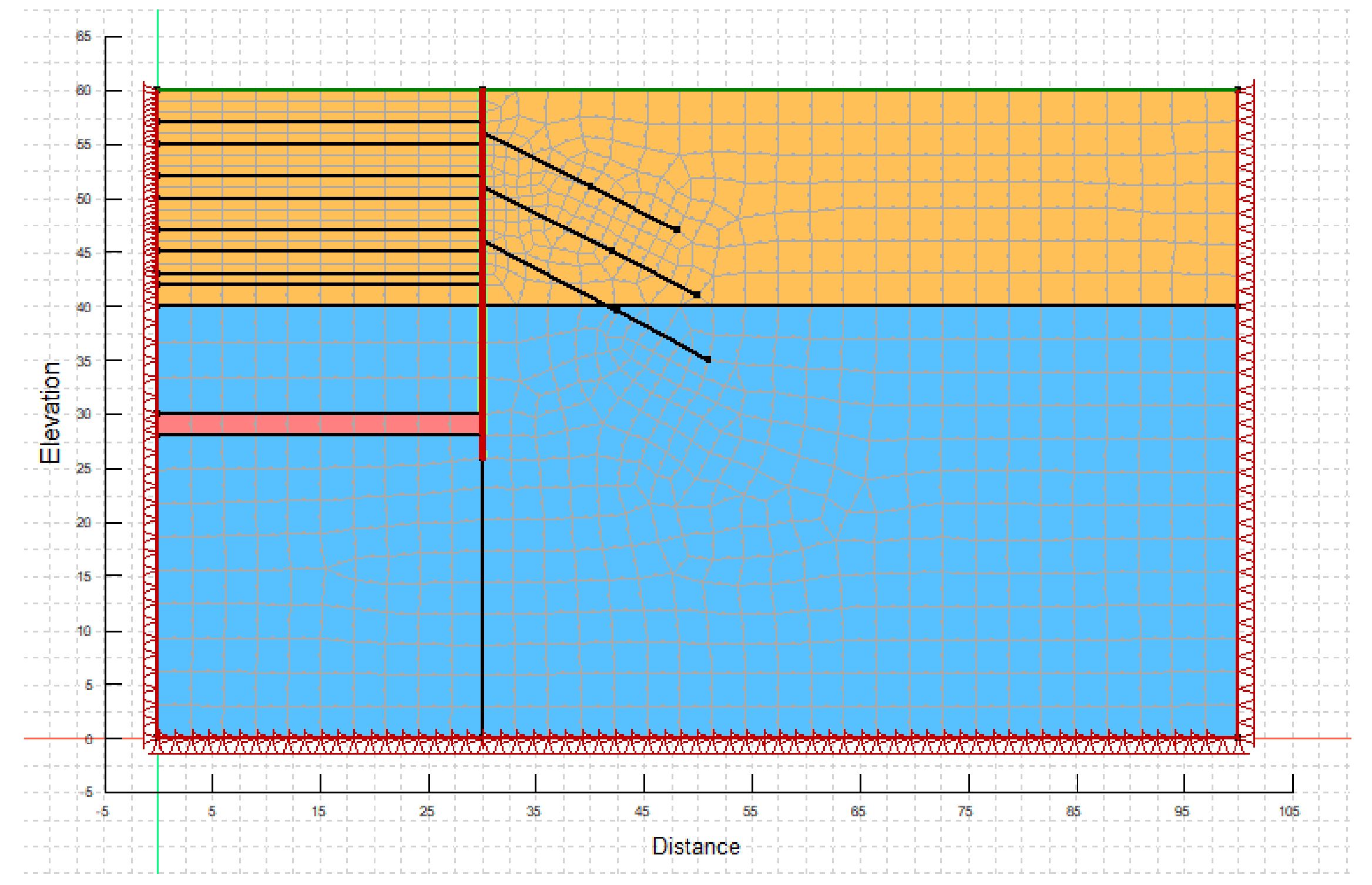

Geometry and excavation stages for the tied back excavation simulated using the Hardening Soil.png
