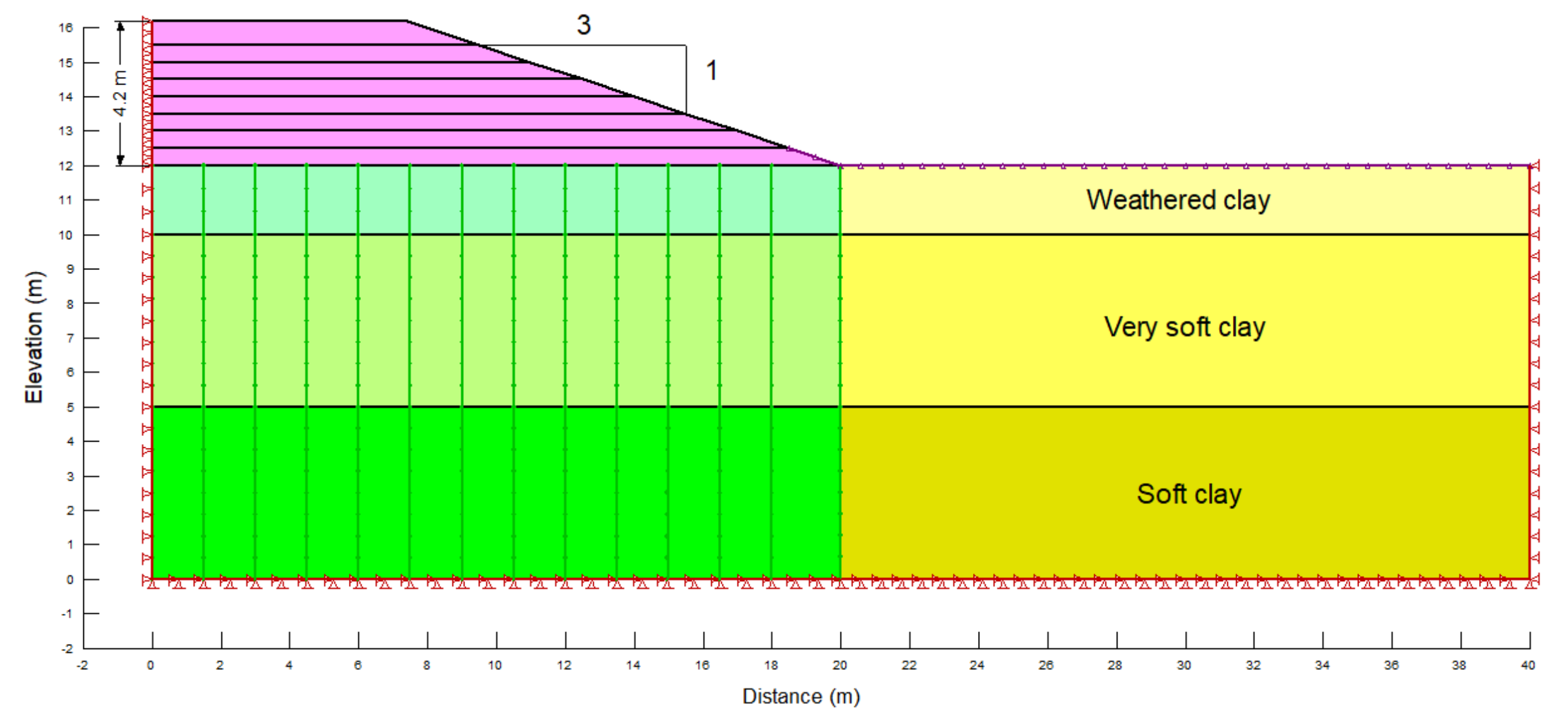

We have re-analyzed portions of this case history to demonstrate how GeoStudio can be used to model the effect of PVDs in the consolidation of soft soils. We have not attempted to replicate all aspects of the published information; rather, our objective is only to provide sufficient information to show how GeoStudio users can do this type of geotechnical numerical modeling.
Position of the vertical drains and layers used for sequential fill placement.png
