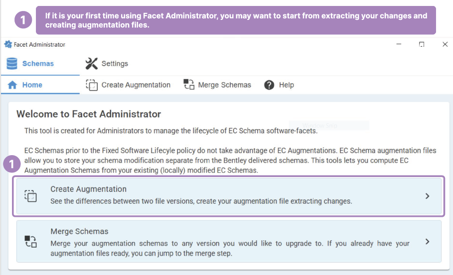

1. Launch Facet Administrator
Open the Facet Administrator tool from your desktop or installation directory.

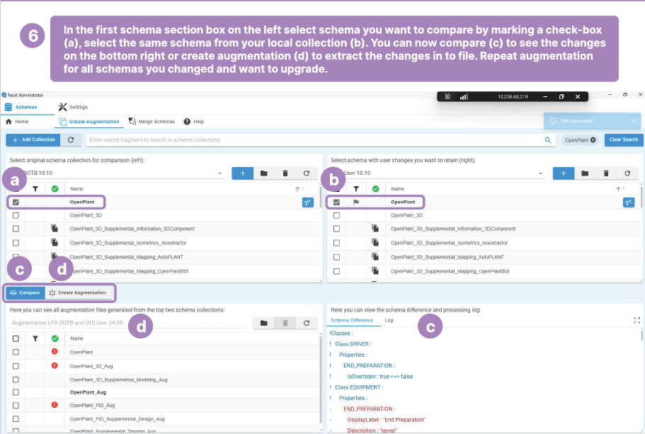

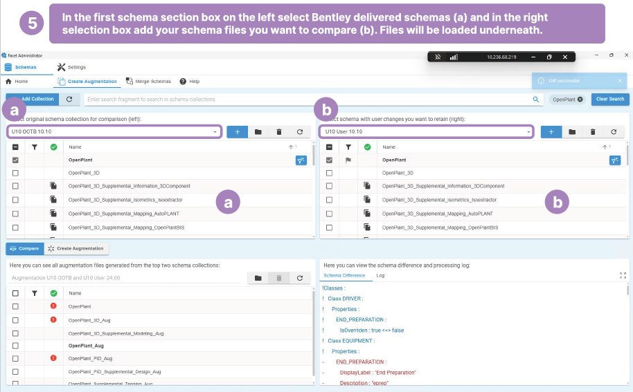

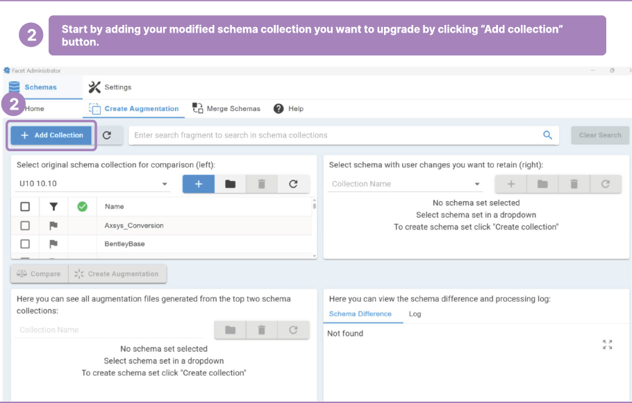

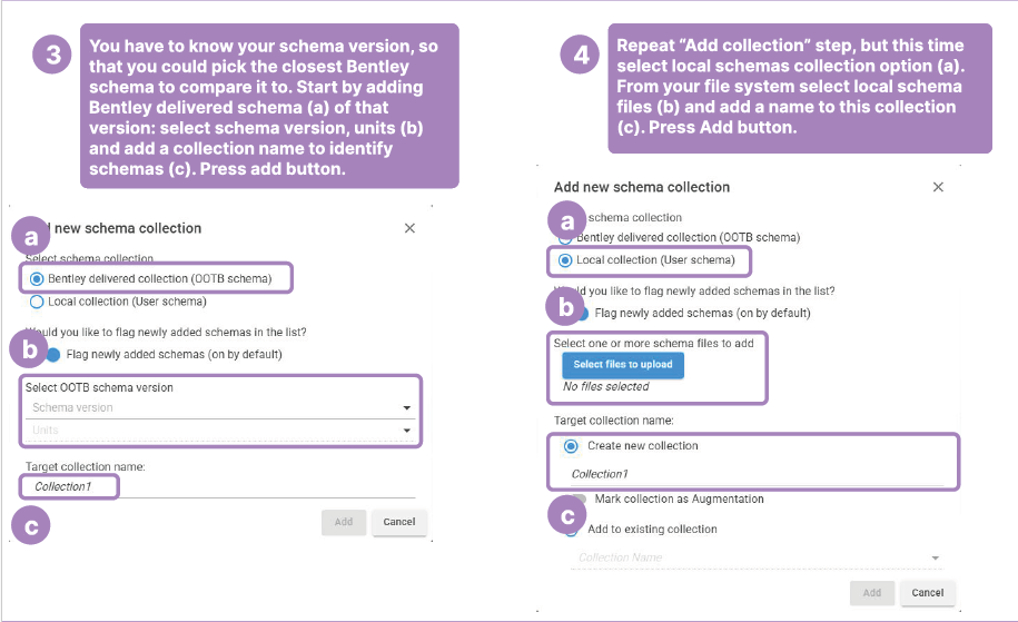

2. Create Augmentation Files
· Navigate to the Create Augmentation tab.
· Add Bentley-delivered schema collection (left panel).
· Add your locally modified schema collection (right panel).
A screenshot of a computer
AI-generated content may be incorrect.
Screens screenshot of a computer
· Use the Compare function to view differences.
· Click Create Augmentation to extract changes into augmentation files.

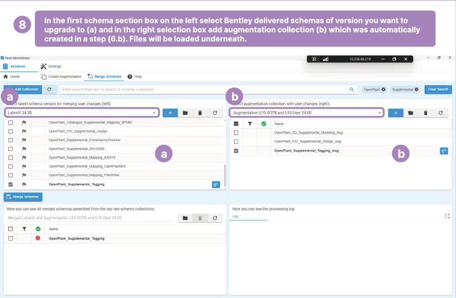

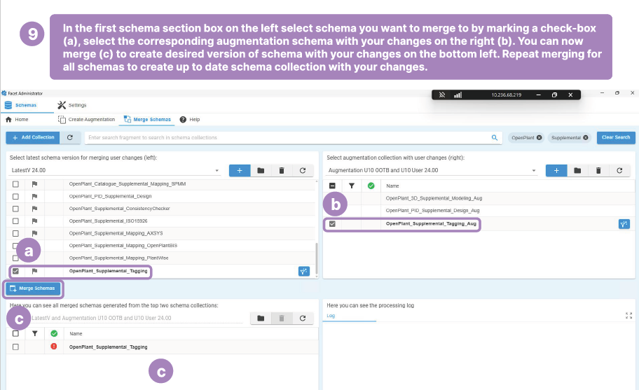

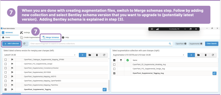

3. Merge Schemas
· Switch to the Merge Schemas tab.
· Add Bentley schema collection for the target version (left panel).
· Add your augmentation collection (right panel).
· Select matching schemas from both panels.
· Click Merge to generate upgraded schemas with your custom changes.

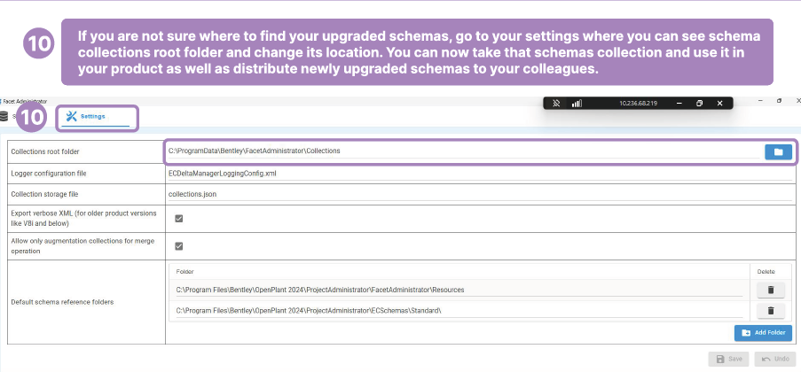

4. Locate Upgraded Schemas
· Go to Settings to view or change the schema collections root folder.
· Use the upgraded schema collection in your OpenPlant product or share with your team.
