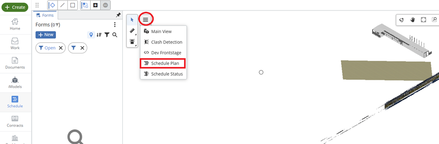

1. Open the Schedule View in SYNCHRO Control
2. Navigate to: Frontstages > Schedule Plan

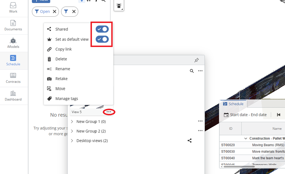

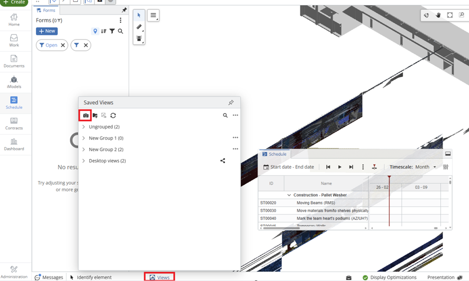

3. Create a new Saved View

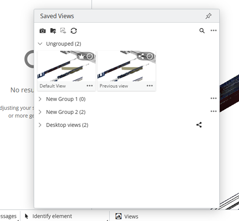

4. Share the Saved View and set the new Saved View as the default view.
The default view will have a crown like symbol as seen in the image above.
This process ensures the default view reflects the correct schedule and animation setup after synchronisation.
