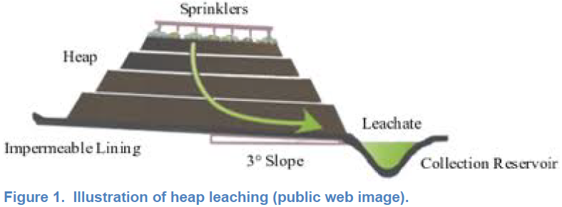

Heap leaching is a mining process to extract minerals from the ore by sprinkling a leach solution on a pile (heap) of ore. As the leaching solution percolates through the ore, the minerals are dissolved and then later are extracted from the leachate collected at the base of the heap. This process is conceptually depicted in Figure 1.
