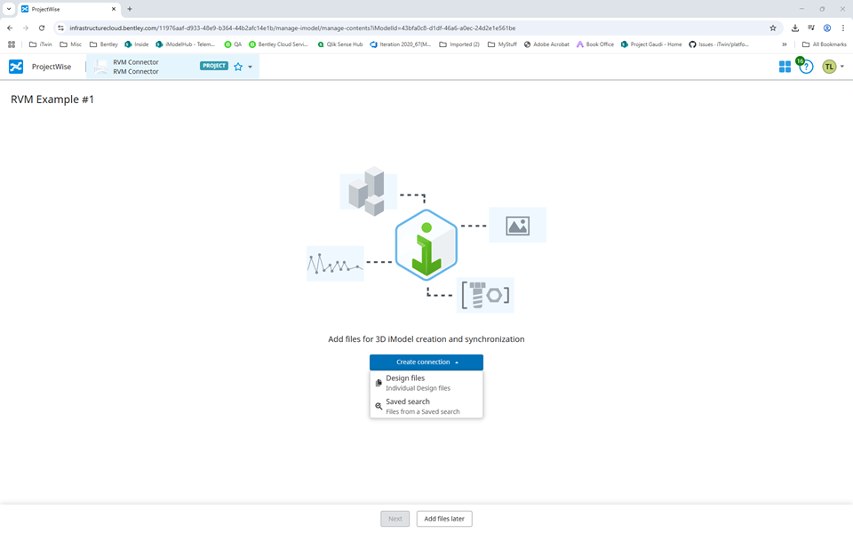

RVM data can be synchronized using Bentley Infrastructure Cloud (BIC) Portal: https://infrastructurecloud.bentley.com/
Once you have created a project in Bentley Infrastructure Cloud and have created an iModel that you want to synchronize with RVM data, create a connection and pick to add Design Files:

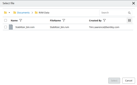

Browse to the location of your RVM data:
Then select the RVM file(s) you wish to synchronize and click Select.

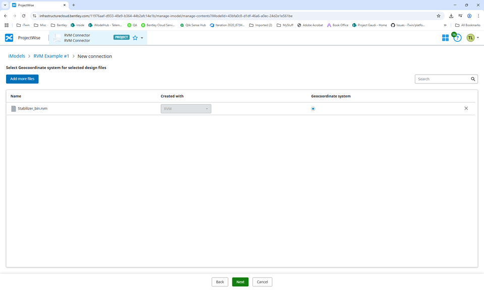

Once you have selected the RVM files, you may have to select one of the files to define the Geocoordinate system if one has not already been defined in this iModel.
Give the connection a name and click Done. If you picked the synchronize manually start the synchronization.
