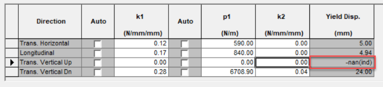

Reason #3:
Check Soil properties, there could be an issue where K1 or P1 values were set to Zero thus causing the calculated Yield Displacement to be -nan (Not a Number) as indicated below.
There is a known modeling technique for representing the absence of soil in a particular direction, indicating that neither K1 nor P1 values should be set to Zero. It is preferable to input a minuscule value to be effectively Zero (e.g., K1 and P1 = 0.001).
