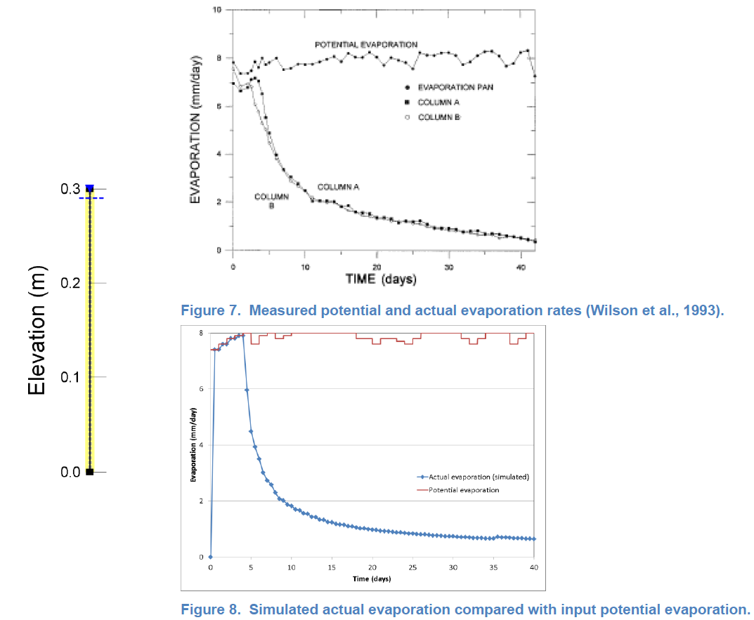

The example illustrates the simulation of actual evaporation from a one-dimensional soil column. Actual evaporation rates are calculated based on the relative humidity within the soil, which is controlled by temperature and matric suction, and the climate conditions as defined by the Land-Climate Interaction (LCI) boundary condition. The simulated results are compared to measurements from a laboratory experiment (Wilson et al., 1993).
