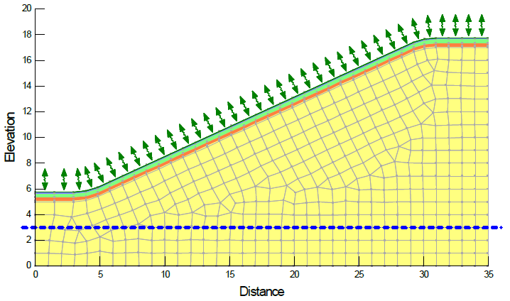

This example illustrates how to simulate the performance of an engineered soil cover system in response to land-climate interaction. The primary objective of the simulation is to assess deep percolation and oxygen ingress through the base of the cover into the waste. A commentary on various aspects of land-climate interaction modeling is discussed, with a particular emphasis on interpreting the results and closing the water balance for the cover.
