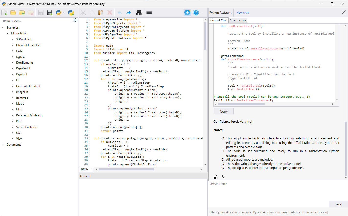

Welcome to the future of design and automation in MicroStation, powered by the innovative Python Assistant. MicroStation 2025 is set to revolutionize your workflow by integrating Python, a simple yet powerful scripting language, with an intelligent AI assistant that makes automation more accessible than ever before.
A screenshot of a computerAI-generated content may be incorrect.

• Natural Language Interaction: Users can simply describe what they want in a few sentences, and the assistant will attempt to generate the corresponding Python code.
• Boosted Efficiency: It automates repetitive and mundane tasks, allowing you to save valuable time and focus on higher-value design work, planning, and conceptualization.
• Increased Accessibility: Even if you're new to programming, the Python Assistant simplifies complex coding concepts and helps you create partial or complete Python scripts. It removes common blockers, enabling you to complete more tasks directly within MicroStation.
• Enhanced Customization: You can tailor tools to your specific project needs, providing a competitive advantage and helping you win more work.
• Learning Support: The assistant can write entire scripts, help with debugging, troubleshoot issues, and provide clear explanations and insights, making the learning of Python syntax much easier. It allows you to focus on what you want to achieve with the script, rather than getting bogged down in low-level programming details.

• Be Specific with Your Prompts: The more detailed your description, the more accurate the results will be. Avoid vague instructions to prevent errors and messy code.
• Embrace Iteration and Testing: The Python Assistant is a non-deterministic system, meaning results can vary. The same question can provide a different answer. It's an iterative process: if the assistant produces errors, copy the error messages directly back into the chat and ask it to fix them. Keep related tasks and iterative refinements within the same chat session to benefit from context window. Frequently take a copy of your script, especially if there is a big change to a large code block. AI has the tendency to try and improve with each iteration, which can lead to breakages.
• Break Down Complex Tasks Iteratively: You can implement a "planning-first" approach yourself by breaking down a large problem into smaller, sequential steps. Prompt the assistant for one part of the solution, review and test its output, and then provide a new prompt for the next logical step, building upon the previous output. This "step-by-step approach" allows you to verify each step and ensures the project stays on track.
• Be Direct and Persistent with the Assistant: The assistant is "determined" to produce an answer and may sometimes "hallucinate" or return less relevant output. You may need to be "brutal" and "strong" with your instructions, telling it exactly what you want and, if necessary, even instructing it to "stop producing nonsense" if it continuously provides incorrect or irrelevant code.
• Always Review the Generated Code: While the Python Assistant is powerful never blindly trust AI outputs for critical work. Always review the generated code carefully.
• Understand Confidence Levels: The Python Assistant may provide a confidence rating (e.g., "90% confident") for the code it generates. Use this as an indicator, but always verify the output.

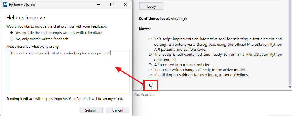

• Leverage Feedback Mechanisms: If a script is unhelpful, you have the option to provide feedback. This can include your chat prompt, helping Bentley Systems to tune the system and improve its accuracy for all users.
• Contextual Awareness: The assistant can maintain context within a rolling last 10 prompts within a single chat session. This means if you ask follow-up questions or provide additional instructions within the same chat, it will consider the last 10 prompts and answers in its history to formulate its response. However, starting a "new chat" means it has no recollection of previous conversations.
• Keyboard Actions: Python Scripting is very sensitive to indentations in the code. Selecting single lines of code or whole code blocks and using TAB indents code. To reverse this use SHIFT + TAB. In the “Ask Assistant” prompting input, pressing Enter will send the prompt to the AI. SHIFT + ENTER will allow a new line. This is common practice for Chat Bots.
