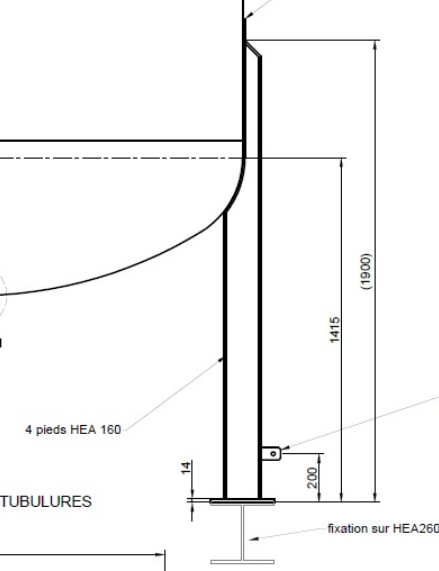

How can we model a leg support flush-mounted on the shell?
Question
Answer

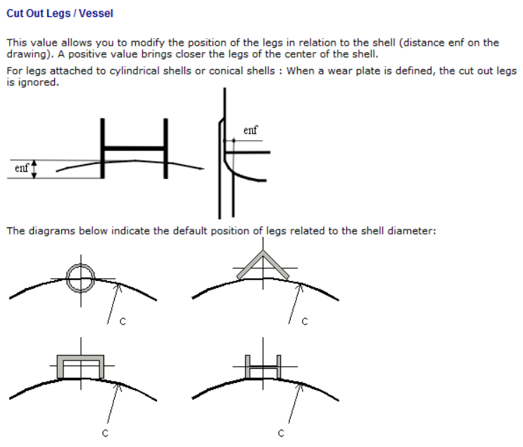

When a Top Pad or Wear Plate is added to the Leg Support, AutoPIPE Vessel does not account for a cut-out in the leg (i.e., Leg support flush-mounted on the shell).
To include a cut-out in the leg section, the Top Pad or Wear Plate should not be applied to the Leg Support.
