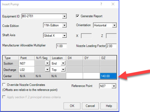

Q. Why are API 610 coordinates on dialog a 100x smaller than reported values?
Example:

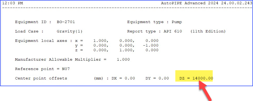

Compare dialog entry for Dz to reported entry for Dz below:
Why is the reported Dz =1400 entry a 100x greater than the dialog entry for Dz = 140 ?
In a documented instance, the cause for this was directly associated with the following reasons:
    1. English language pack missing from the Windows configuration
    2. Window's Regional format for decimal separator must be decimal and not period.
After addressing both of these issues, rebooting the computer, open the model again, the problem was resolved where both the dialog and reported values matched
