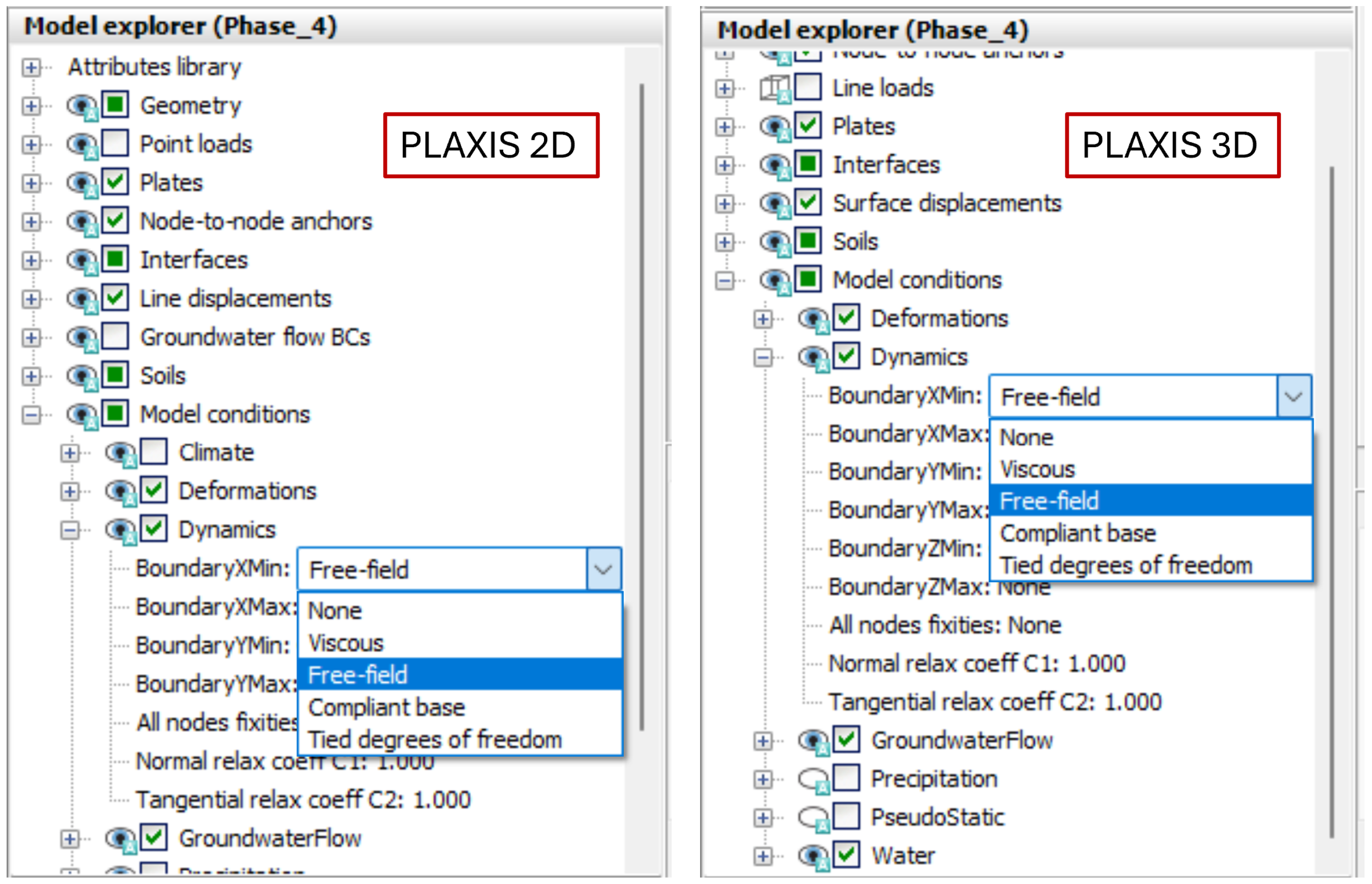

When opening existing projects in PLAXIS 2D or 3D 2024.3 (24.03.00.95), the software incorrectly displays all available dynamic boundary condition options (None, Viscous, Free-field, Compliant base, Tied degrees of freedom) for each model boundary (e.g., BoundaryXmin, BoundaryXmax, BoundaryYmin, etc.), regardless of whether they are valid for that specific boundary.

This means, although all dynamic boundary condition options are visible in the Model explorer, only the valid options listed above should be used. For instance, the Tied Degrees of Freedom feature is not supported in PLAXIS 3D. Unfortunately, PLAXIS Input does not provide a warning during calculation if an invalid option is used, which may result in unexpected dynamic boundary behavior.
This issue occurs only when opening an existing project in PLAXIS 2D or 3D 2024.03. It does not affect newly created project files, where the correct boundary options are displayed as expected.
