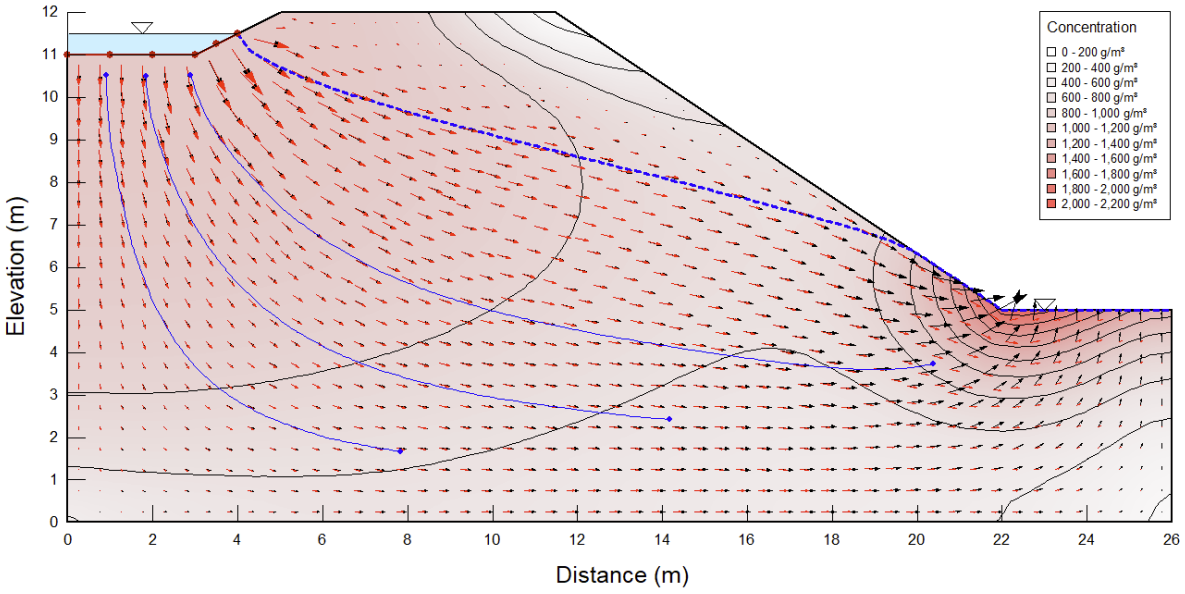

The objective of this analysis is to demonstrate how CTRAN/W can be used to model solute transport by advection and dispersion. The analysis involves establishing the groundwater flow conditions and defining the appropriate material properties and boundary conditions. It also highlights the importance of selecting the correct solute boundary condition at the groundwater discharge location.
