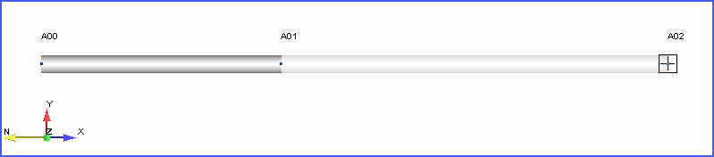

  1. Model horizontal pipe

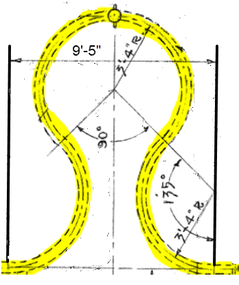

  2.  While observing the double offset Expansion return see that the entire routing is comprised of tangent bends connected together. Therefore, one can make this component using 2 different methods or a combination of each method:

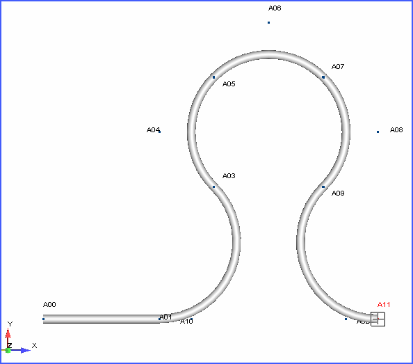

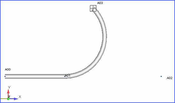

  4. Next, Using the bend command, insert an arc of 135 deg. and 40 inch rad
  5. Insert Bend - use DX = 8'0.6000" bend radius = 40 inches
  6. Insert Run - use Dx = -5'8.3065", Dy = 5'8.3065"

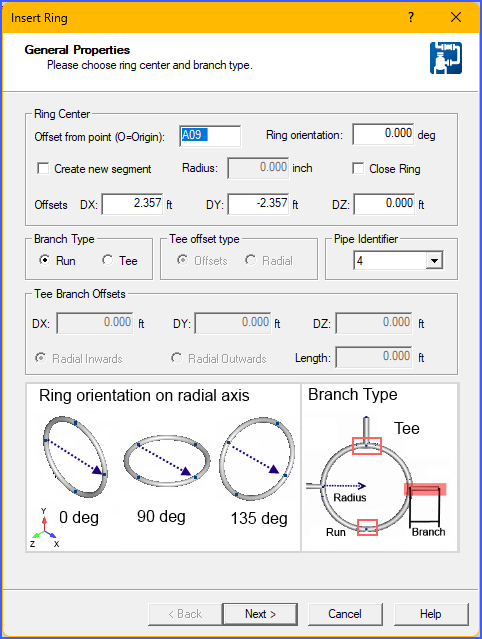

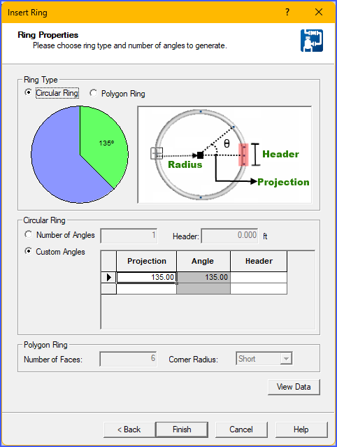

  7. Insert Ring using dialog settings below:
  8. Press Finish button

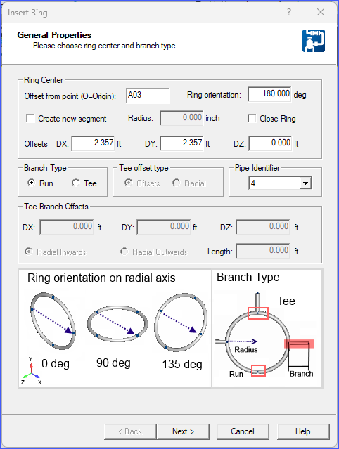

  9. Insert Bend, mimic the previous steps above but backwards, Or insert a ring

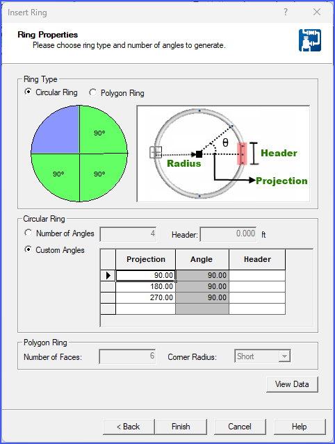

  10. Insert Ring using setting shown below:
  11. Press Finish Button

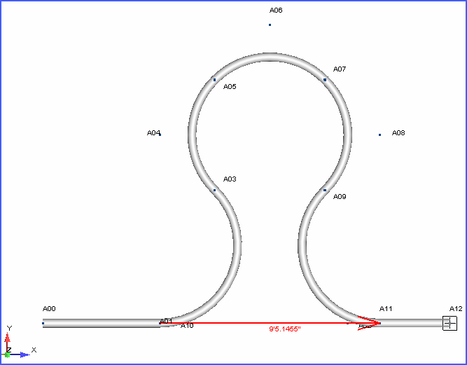

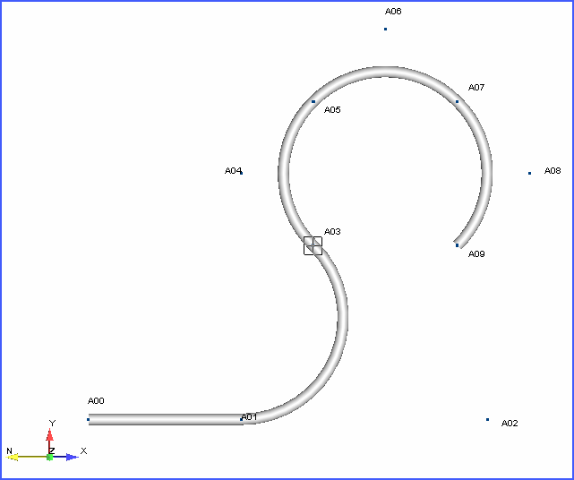

  12. To finish the modeling approach, add next run point and verify dimension from Start to Finish of expansion loop (should be 9'5")
  13. The final verification dimension might be somewhat inaccurate due to AutoPIPE's constraint of handling numbers exceeding 9 digits.
Conclusion:
By using a bit of Trigonometry and AutoPIPE, one can effortlessly model a complex double bend expansion loop utilizing the bend command, the ring command, or a combination of both.
