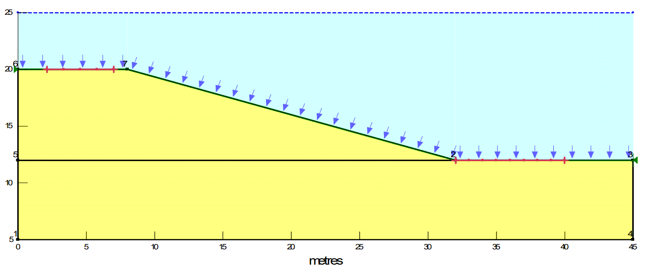

Analyzing the stability of subaqueous slopes and embankments requires some special considerations in SLOPE/W, particularly if excess pore-water pressures due to loading are involved. This illustrative example highlights the issues and discusses techniques available in SLOPE/W.
