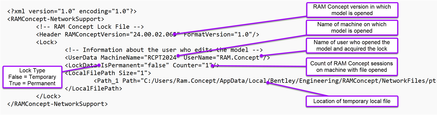

The lock file is an xml file with a .lock extension that is saved in the same directory where the network file is saved. This file stores information about the lock and its owner. See the image below for details about the file contents.

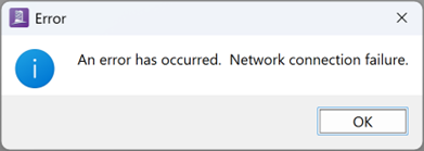

An error has occurred. Network connection failure.
This error is issued when the network connection is lost and a network file save, close, or a file lock change is attempted. In these cases, the network connection failure prevents RAM Concept from updating the temporary local file or the lock file.

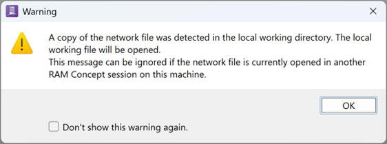

A copy of the network file was detected in the local working directory.
This warning is issued when a network file is open and an exising local file that is linked to the network file is found in the local working directory. This most often occurs when a network file is opened simultaneously in multiple RAM Concept sessions on the same machine. As noted in the warning, RAM Concept will open the existing local file.

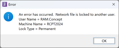

An error has occurred. Network file is locked to another user.
This error is issued when a user attempts to open a network file that is locked to another user. This applies to both temporary and permanent file lock types.

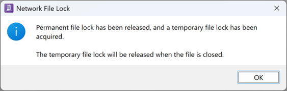

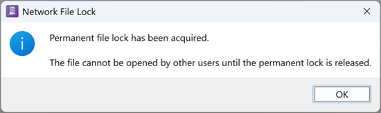

Network File Lock Notifications
The messages below are produced when a permanent file lock is successfully acquired or released.

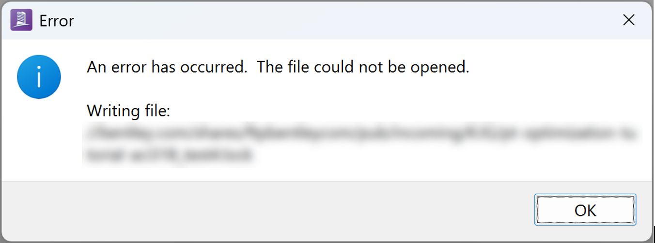

An error has occurred. The file could not be opened.
This error is issued when attempting to open a network file and information cannot be read into the lock file due to a connection issue. Typically, this error is caused by a weak network connection. If the error persists after several tries, copy/paste or save the network to a local file directory and then try again.
