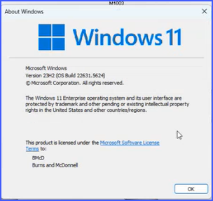

- Also In the case, please provide the version of Windows being used, (select the Window's search bar and enter "WINVER", run this command to display version of Windows installed) Example:
