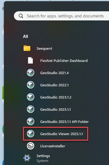

- Start Menu Shortcut
- Look for a shortcut labeled "GeoStudio Viewer" in the Start Menu.
- This is distinct from the regular "GeoStudio" shortcut used for full-feature access.

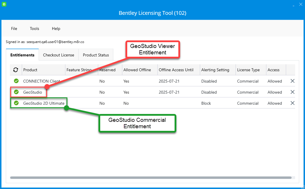

- Bentley CONNECTION Client Sign-In
- You must be signed in to the Bentley CONNECTION Client to use GeoStudio Viewer.
- The Viewer uses a free license entitlement labeled "GeoStudio" in the CONNECTION Client License Tool.
- This is separate from commercial entitlements like "GeoStudio 2D" or "GeoStudio 3D".

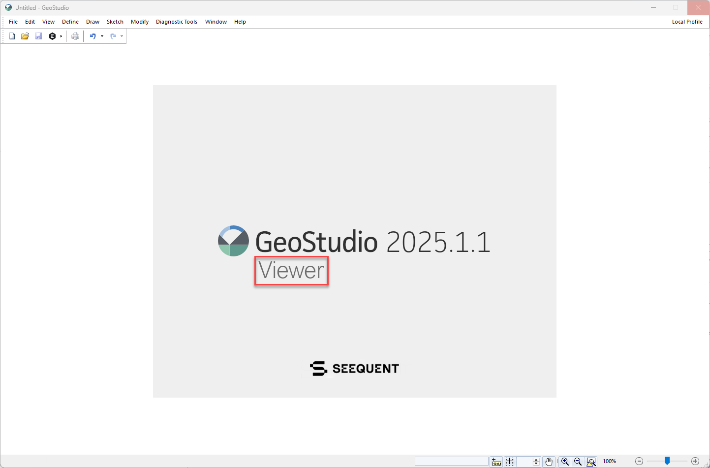

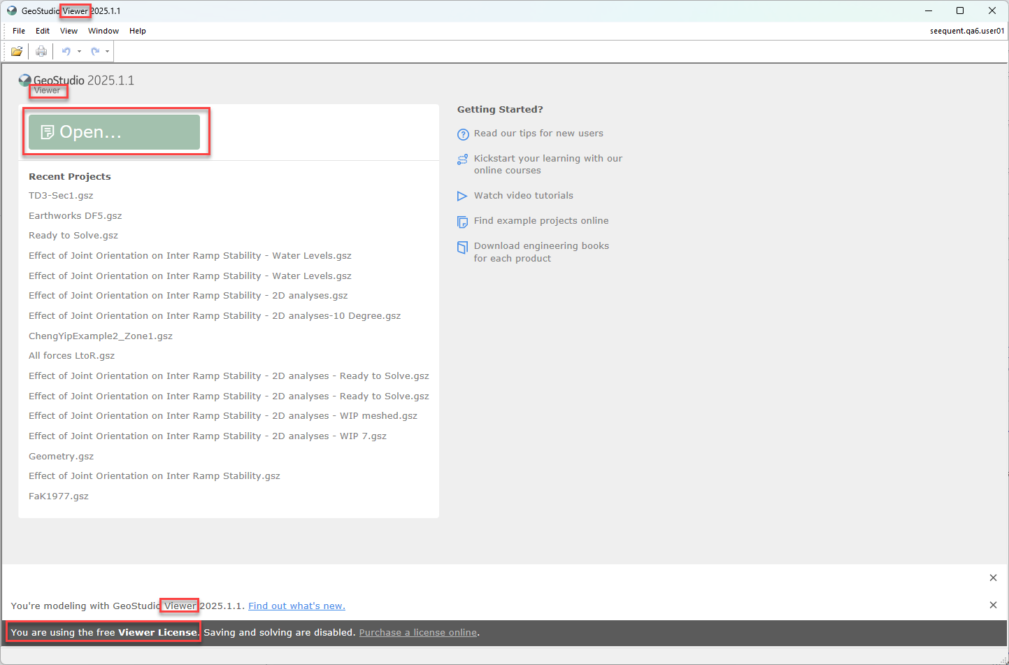

- Visual Indicators in the Application
- When launched, the application will clearly display the word "Viewer" in the user interface.
- Some user interface elements of the application window will have a light-green shading, helping distinguish it from the full version.
