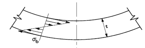

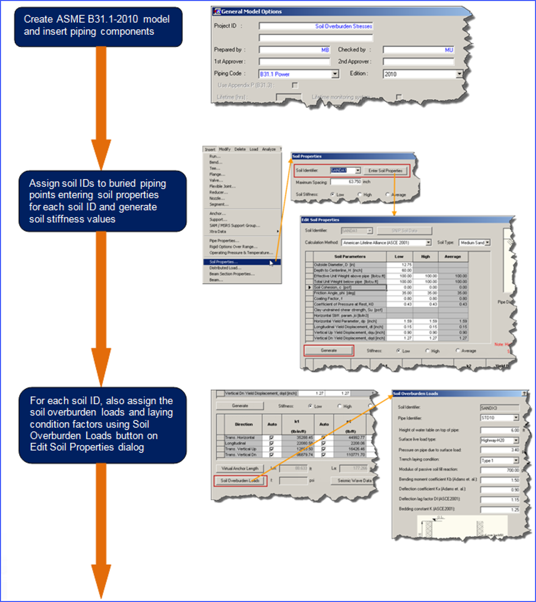

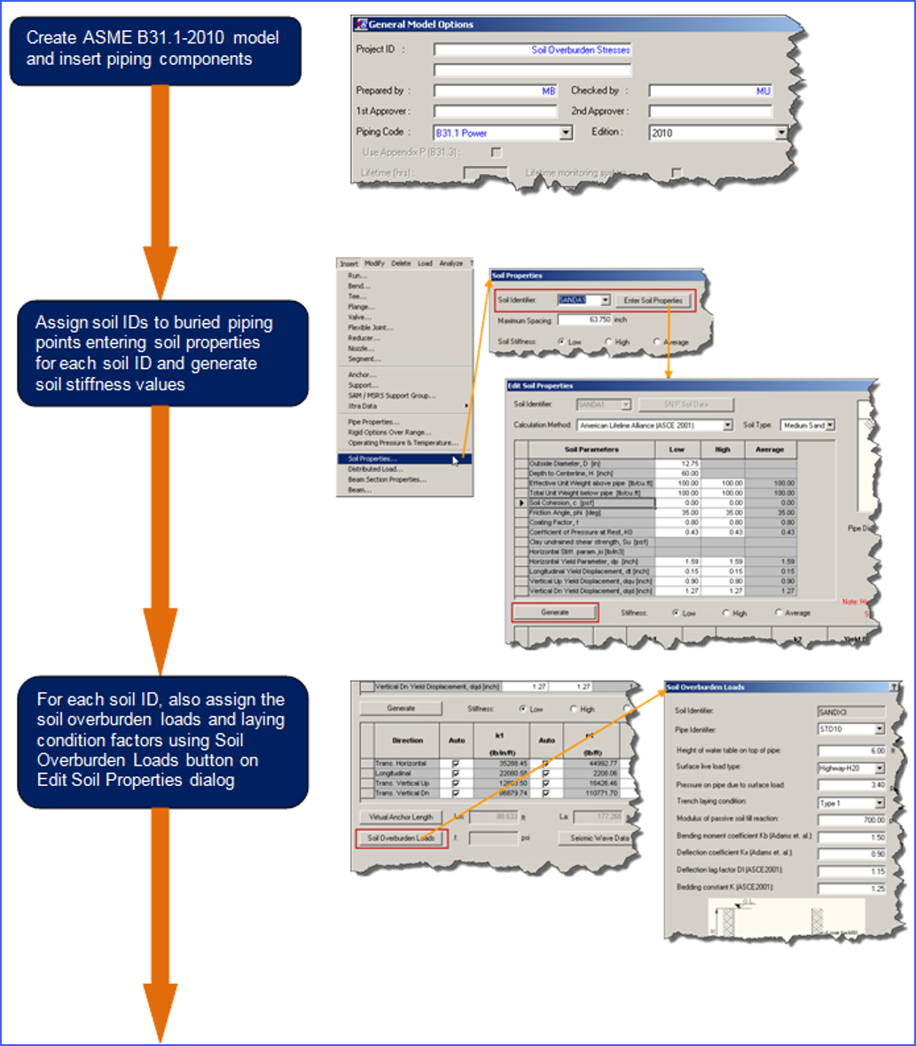

Circumferential wall bending stress
- Earth loads calculation
- Surface loads
- Three equations for calculating stress
- Adams et. al.
- AWWA C150
- ASCE 2001
- Additional options for adding stress to sustained stress

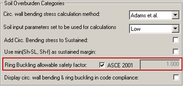

Ring buckling pressure
- Total vertical pressure applied
- Limit of applied pressure
- Ring buckling allowable safety factor

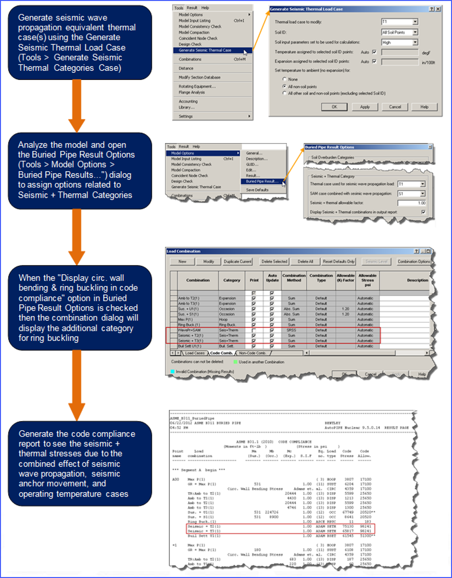

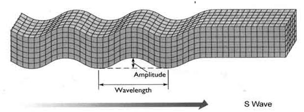

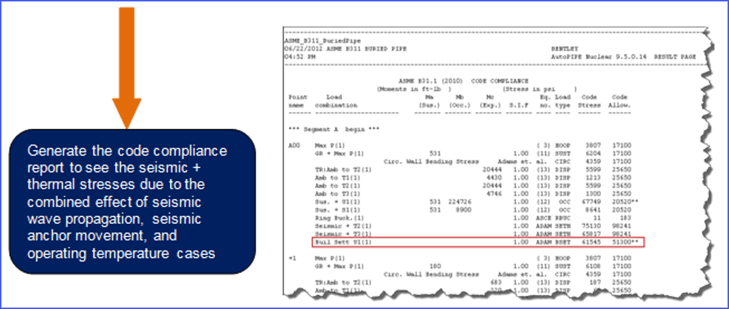

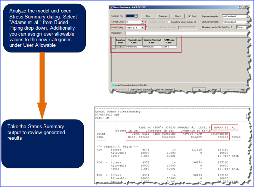

Seismic + Thermal stress
- Combines Permanent (temperature) and Occasional (SAM + Wave propagation) effects
- Allowable stress proposed by Adams
- Thermal equivalent due to wave propagation

Workflow – Circumferential wall bending stress
Workflow - Seismic + thermal stress
Workflow - Building settlement

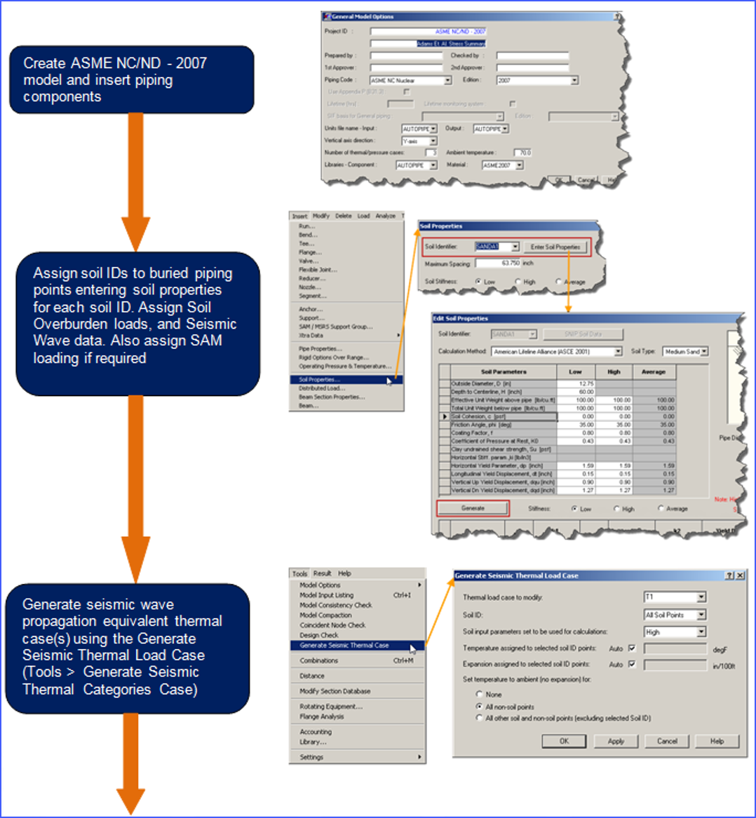

Workflow - ASME NC/ND
