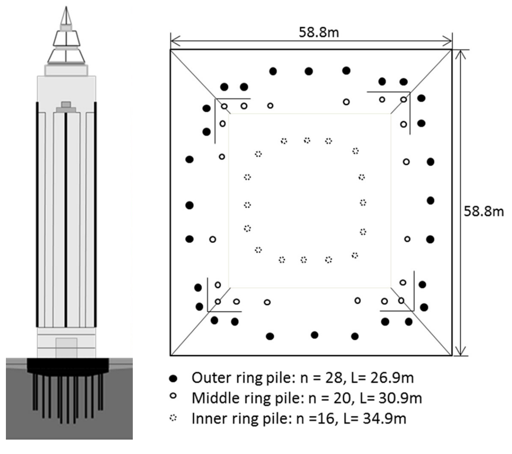

The Messeturm in Frankfurt is a high-rise tower founded on a compensated piled raft foundation. This type of foundation is particularly well suited for high-rise buildings constructed over soft or compressible soils, as it combines the benefits of raft and pile foundations while mitigating total and differential settlements. The concept of compensation in this context refers to the idea of balancing the applied building loads with the weight of the excavated soil, thereby reducing the net stress increase imposed on the subsoil.
View of the Messeturm Tower and arrangement of piles
Figure 1: View of MesseTurm Tower and arrangement of piles (Kumar et al. 2016)
