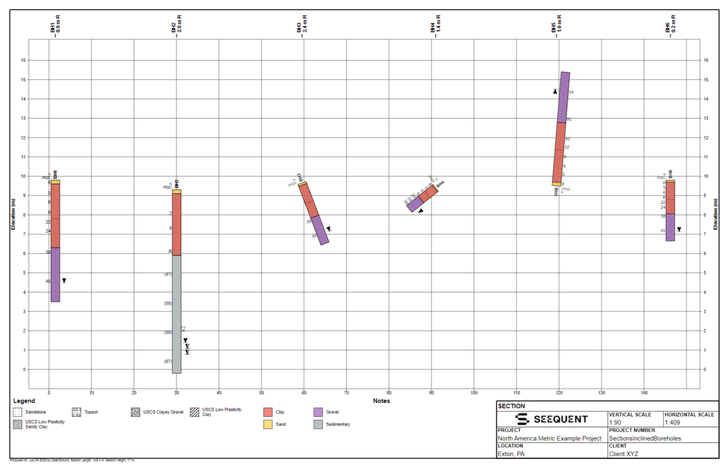

Starting with version 10.0.1.2948 of OpenGround Professional, inclined boreholes can be displayed on Quick Sections.

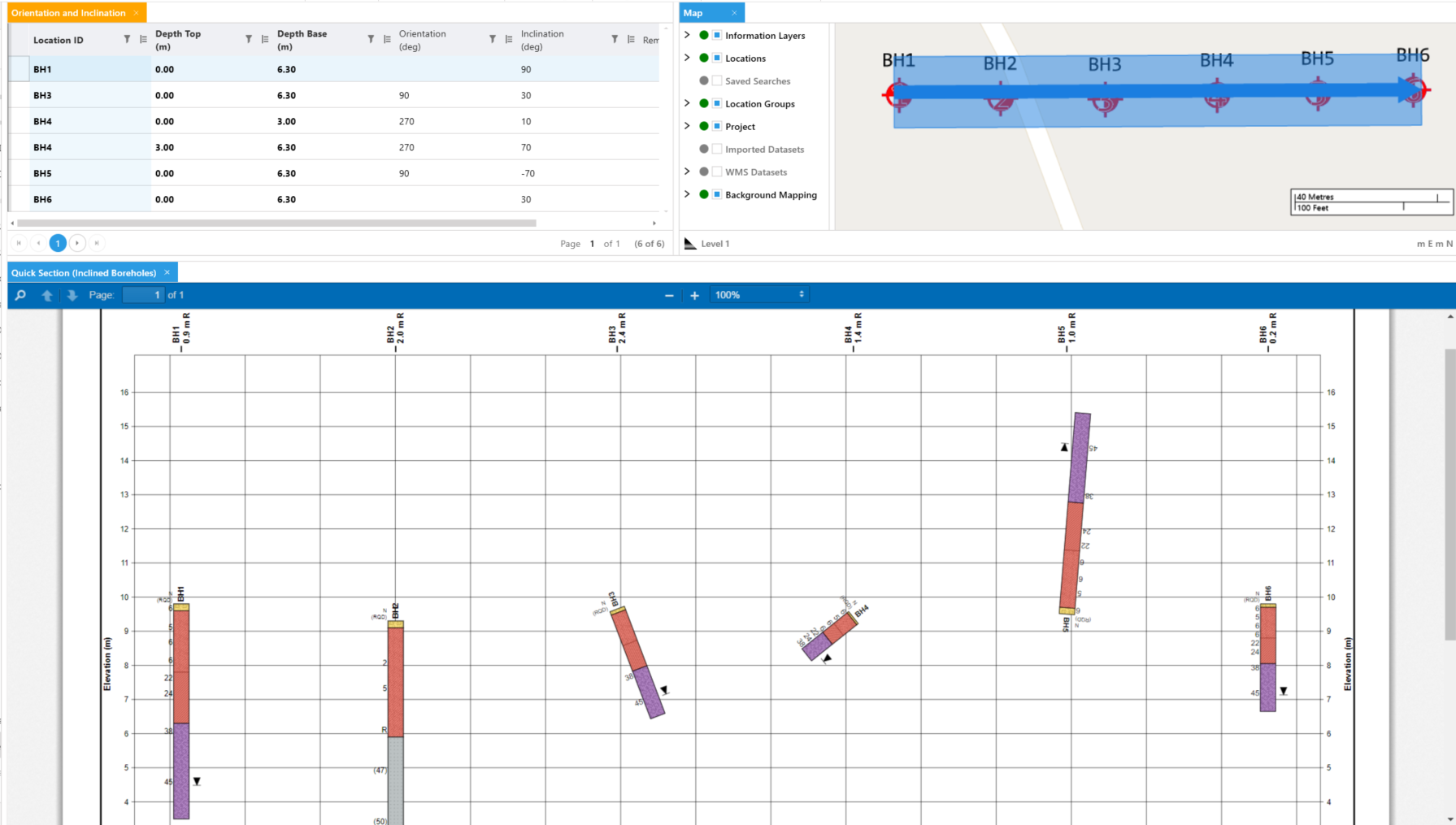

Boreholes are drawn based on data from the Orientation and Inclination group.
For details, see the Inclined Boreholes Guide, but in short:
Key Behavior
Example Boreholes
Borehole  Description
BH1 Inclination = 90° → Drawn vertically down.
BH2 No orientation/inclination data → Defaulted to vertical down.
BH3 Orientation = 90°, Inclination = 30° → Drawn at an angle, roughly parallel to the section line.
BH4 Two entries (deviated borehole) → Only top record used: Orientation = 270°, Inclination = 10°. Drawn accordingly.
BH5 Inclination = -70° → Drawn upward (e.g., drilled in a tunnel or rock face).
BH6 Orientation = blank (defaults to 0°), Inclination = 30° → Since it's perpendicular to the section line, it appears vertical but shorter. (For comparison, BH6 has the same true length as BH1.)
