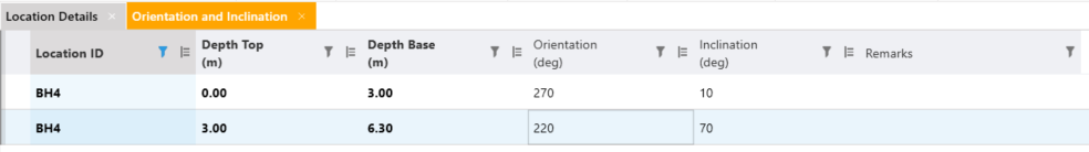

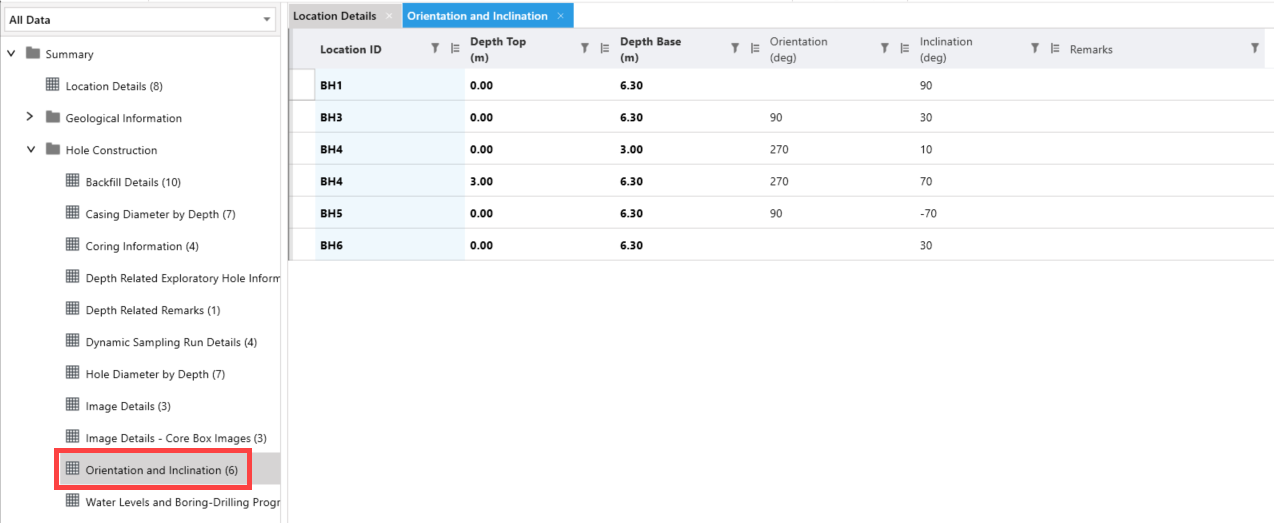

In OpenGround, the Orientation and Inclination group (OrientationAndInclination) is used to define the direction and angle of inclined (non-vertical) boreholes.
Note: For vertical boreholes, this information is typically not required.

Inclination
Examples:
Borehole Angle Inclination
Vertical down 90°
Vertical up -90°
Horizontal 0°
30° below horizontal 30°
Important: Inclination in OpenGround is stored the opposite of gINT. If importing data from gINT, reverse the inclination sign.
Multiple Orientation/Inclination Entries
OpenGround supports multiple entries for Orientation and Inclination at different depths to represent deviated boreholes.
Note: Some features in OpenGround only support a single orientation/inclination per borehole (see links below).
