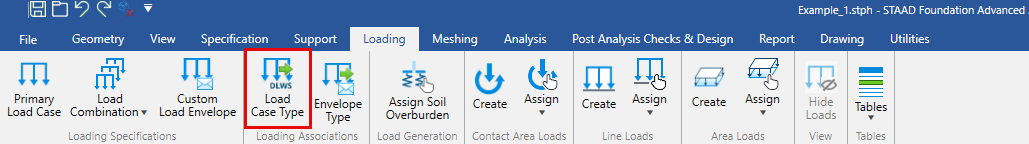

Users can click on the following option under the Loading tab to define load case type if it is not identified by program.
Figure-1

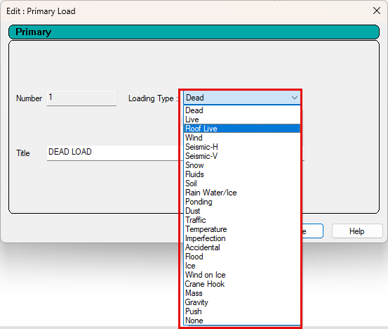

Program auto identify the type of load case if it is defined in STAAD.pro. refer below snap showing the load types available in STAAD.pro.
Figure-2

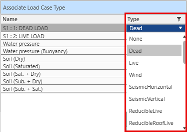

If the load cases available in the STAAD.pro file are assigned with loading types, program auto identifies the load type. However, option is provided to user to change the load type. If the load type is missing in STAAD.pro, option is available to define it in the program.
Figure-3
It is important to define the load case type on this screen to make sure that its effect should be considered on the design. Example: for earthquake and wind load combinations it is allowed to increase the permissible soil bearing capacity as per Indian design code. Based on type of load the strength reduction factors vary as per Euro design code.

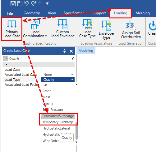

Step-2: Adding Permanent and Temporary surcharge load on footing
Program allows users to add primary load cases other than defined in STAAD.pro. If you click on the tabs shown below, list of load type would be available to user.
A permanent and temporary surcharge can be created by adding a new primary load case.
Figure-4

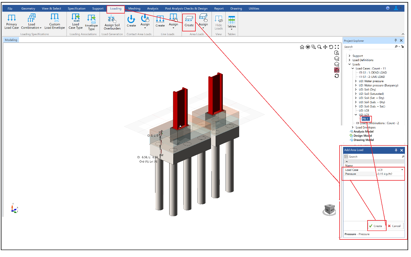

Click on the Create button of Area load under Loading tab. User can provide the Name for the load and select the load case. As it is an area load, user can provide the pressure intensity. After providing the information click on the create button on left bottom side and add the load under load case.
Figure-6

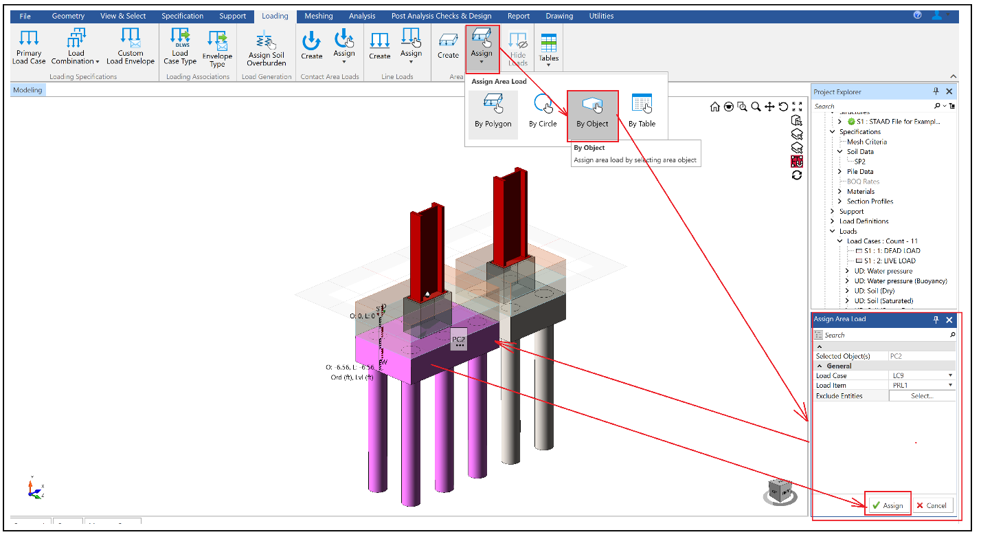

After adding load for Load cases, the next step is to assign it to pile cap foundation. Click on the Assign button of Area load under loadings. There are various options available to assign load to pile cap foundation. Select one of them and select load case and load item. Select the pile cap foundation and click on the assign button on bottom left.
Figure-7
The load has been assigned to pile cap foundation.

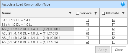

Step-3: Load combinations Type
To assign load combination type, the user must click on the following option under Loading tab.
Figure-10
Program auto identifies the load combination type whether it is service or ultimate based on the load factors. Facility is available to change the load combination type on this screen. At a time one LC type can be assigned to one load combination. Option is also provided to keep the load combination un-ticked in case it is not used for sizing and design.
Figure-11

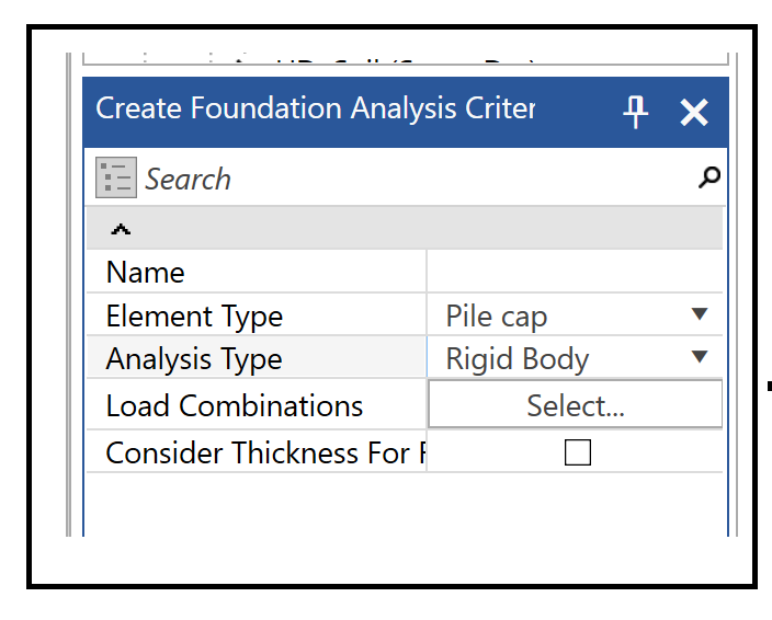

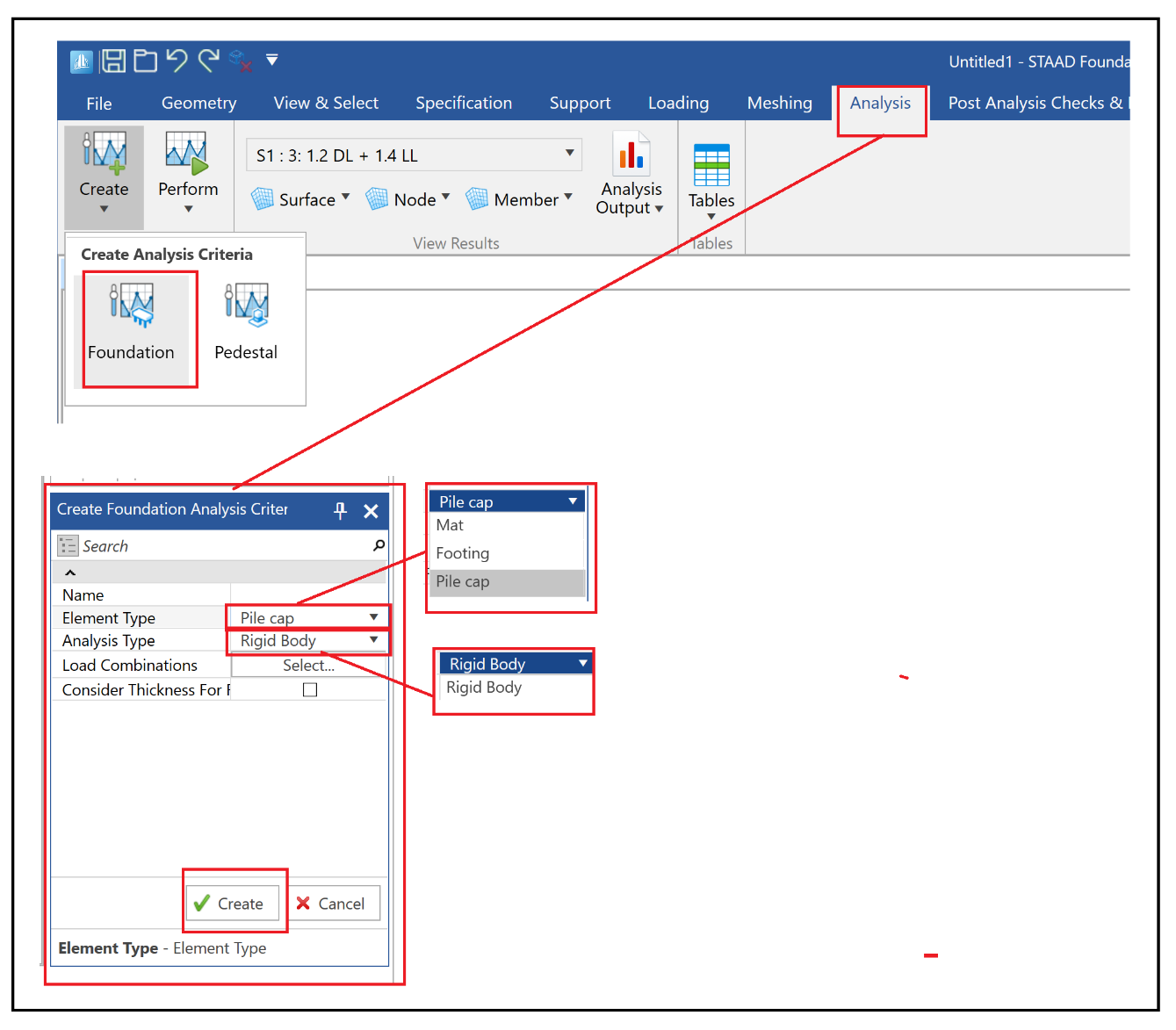

Next step is to define analysis criteria. To create an analysis criterion, refer to the snapshot below,
Figure-12
Upon clicking on the Foundation button, the following inputs would be available to define analysis criteria.
Figure-13
Element Type: The pile cap can be designed as a rigid or flexible pile cap.
Analysis Type: For pile cap foundation, Rigid and Finite element analysis are available. Users can select the analysis type for pile cap foundation as per design requirements.
In this example, we have created analysis criteria as AC1 (Rigid) for pile cap foundation PC1 and AC2 (Finite element) for PC2.

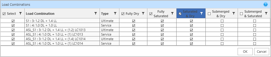

Load combinations: Based on the soil and water level, users can select the load combinations for design of pile cap foundation. By-default fully dry, fully saturated and Saturated and dry options are selected by the program. Users can select these options based on the project requirements. If users have un-ticked all the options, program always select the minimum fully dry options for the design. Users can select all the load combinations by selecting the tick button which is available along with the title of the load type. However, a facility is provided to select individual load combination for that load type.
Figure-14
Consider Thickness for Force Transfer:
If this option is ticked, the load from the pedestal/column would be transferred to the bottom of pile cap foundation. Or else load would be transferred to top of pile cap foundation.
Users can create more than one analysis criteria and assign to different pile cap foundations. One pile cap can be assigned with analysis criteria created using rigid design approach and another pile cap can be assigned with analysis criteria which is created for finite elements analysis type.
