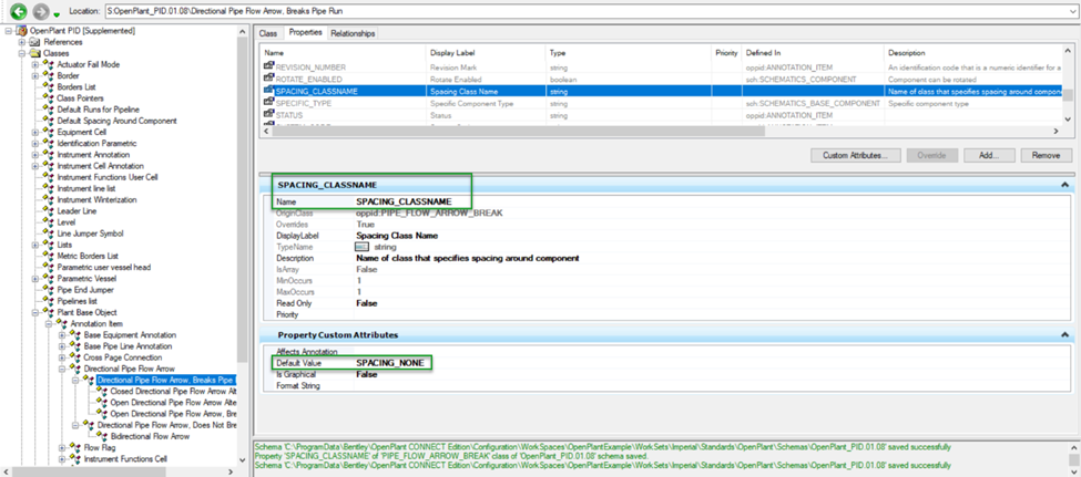

Problem Background

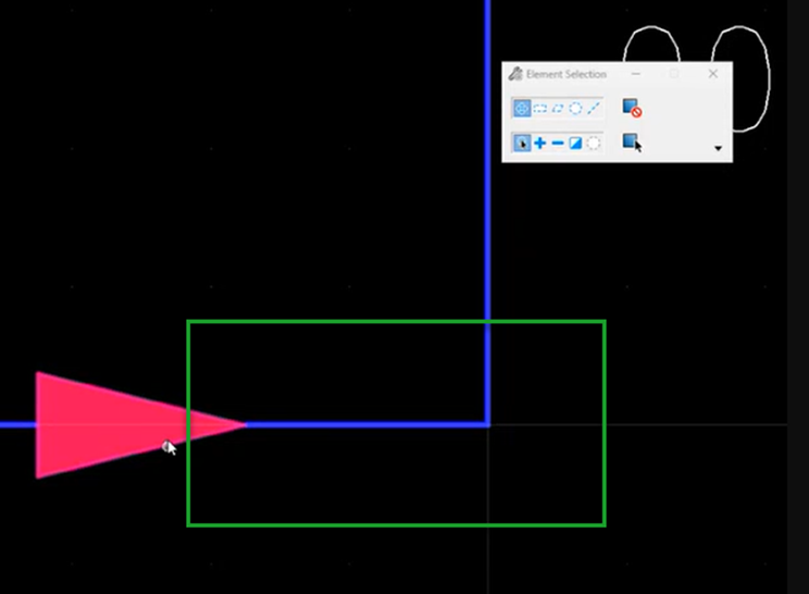

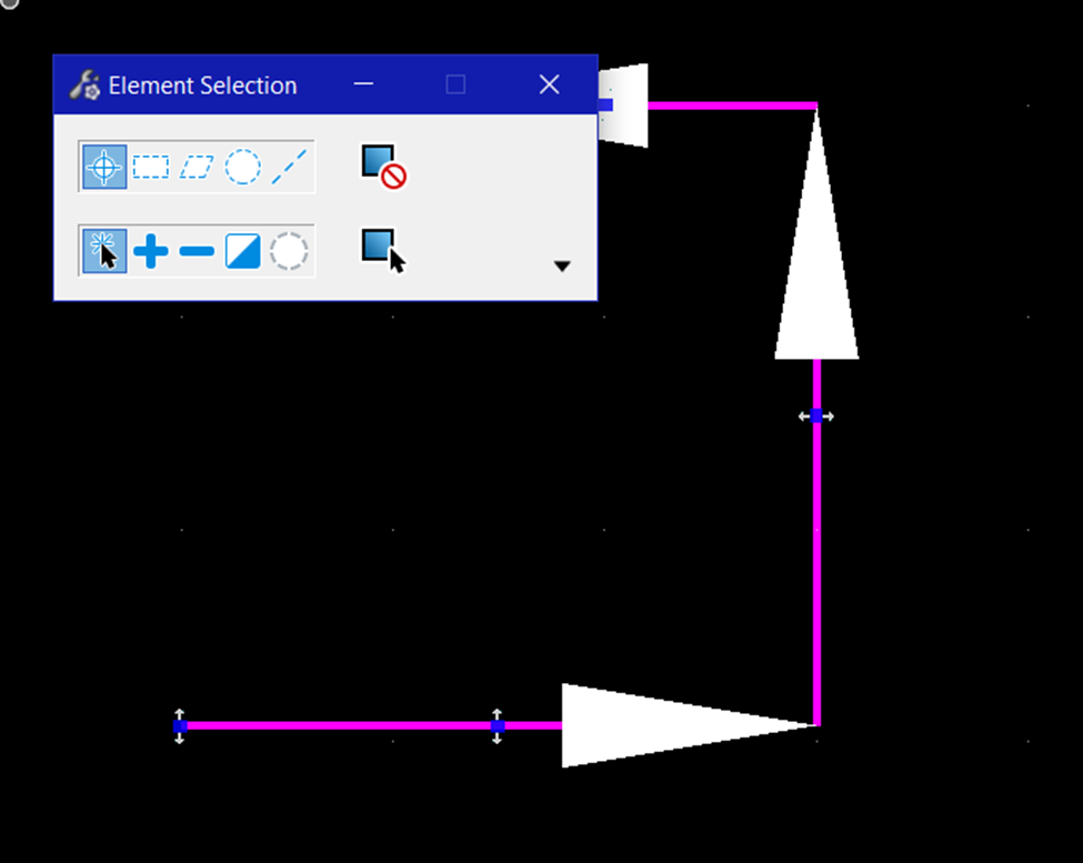

In OpenPlant PID, there is a scenario where the user needs to place the flow arrow on the edge or at the end of the next flow arrow. The excess space can be eliminated by modifying the schema. The goal can be achieved by applying the provided steps.
1. Launch the Bentley Class Editor and open the OpenPlant_PID.01.08.ecschema.xml.

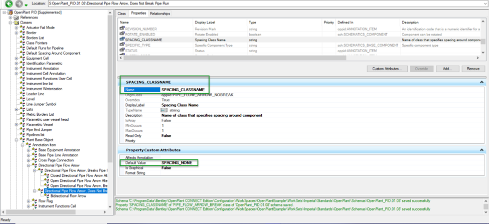

2. Search for the Directional Pipe Flow Arrow, Breaks Pipe Run and Directional Pipe Flow Arrow, Does Not Break Pipe Run class.
3. Locate SPACING_CLASSNAME property then change the default value to SPACING_NONE.
4. Open the dgn in OpenPlant PID and place the flow arrows to verify the result.
