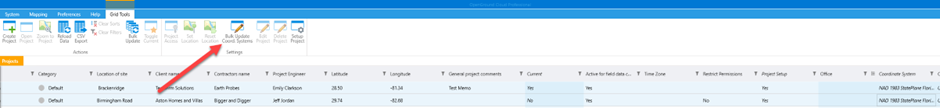

  1. Select the Projects
    Navigate to the Project grid and choose the projects you want to update.
  2. Click “Bulk Update Coord. Systems”
    This option allows you to apply changes to all selected projects simultaneously.

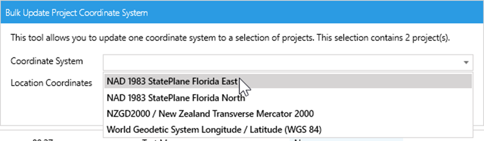

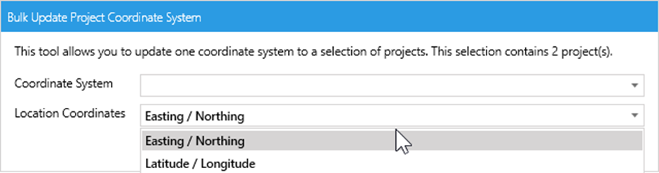

  3. Choose the Desired Coordinate System
    From the list, select the coordinate system you want to apply.
  4. Confirm and Update
    Pick the coordinate system you want to keep and click Update to apply the changes.
