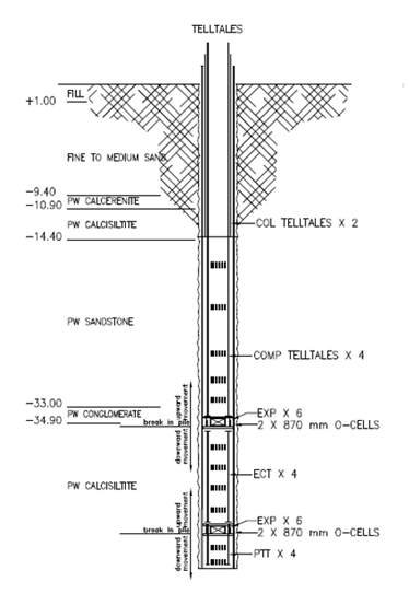

Figure 1: Pile-load test configuration - Stratigraphy and cell locations
The pile configuration under investigation is shown in Figure 1. Concrete was placed only between elevations -14.0 m and -51.3 m. A temporary steel casing was installed above -14.0 m to prevent shaft friction between the pile and the surrounding soil. The load testing was performed on a 1000 mm × 2800 mm barrette using two distinct O-cell assemblies positioned at different depths:

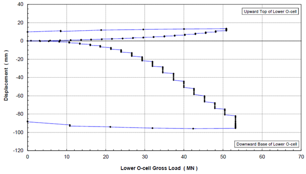

The experimental results from these tests are presented in Figure 2.
Figure 2: Pile-load test experimental results
