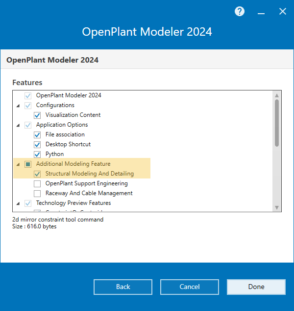

The workset is migrated from CONNECT Edition to 2024. However, when a DGN is opened in OPM, the following error appears:
This error is related to the Structural Modeling/ProStructures feature in OPM and could be resolved by following the steps mentioned below.
Steps to Resolve
1. Copy IntegratedStructuralModel.09.03.ecschema.xml and StructuralModelingComponents.09.03.ecschema.xml from the Out-of-the-Box workspace standards (C:\ProgramData\Bentley\OpenPlant 2024\Configuration\WorkSpaces\OpenPlantExample\Standards\OpenPlant\Schemas\) into your workspace-level standards schema folder
*if you wish to use structural modeling or ProStructures in your workset, kindly proceed,
2. Ensure that installation of OPM 2024 includes Structural Modeling and Detailing:
If this was not done during the installation process, kindly go to Programs and Change OpenPlant Modeler such that it would include that feature.
