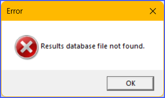

Error - Results database file not found... message is shown in AutoPIPE
The following Error message was shown in AutoPIPE when trying to generate the Results Grids:
Error
OK
Why and how to resolve it.?
Lets be sure there are no troubles with the installation by performing the following:
    1. Reboot the computer
    2. Sign into to Connection Client
    3. Open AutoPIPE
    4. Open Example Model: Walkthru.APC
    5. Press Analyze Static.
    6. Press Result Grid (Home > Results > Result Grid) command.
What happens, does the results grids appear?
Suggestion #1:
Perform general steps to display the results grids.
    1. Open your affected model in AutoPIPE.
    2. Press Delete Analysis Results (Analysis > Delete > Analysis Results).
    3. Next, press Analyze All (Analysis > Analyze > Analyze All) command.
    4. Be sure one or more have been analyzed: Static analysis, Modal analysis, Dynamic analysis, Seismic Anchor Motion
    5. Finally press Result Grid (Home > Results > Result Grid) command. AutoPIPE should take a little time to process before displaying the results grids.

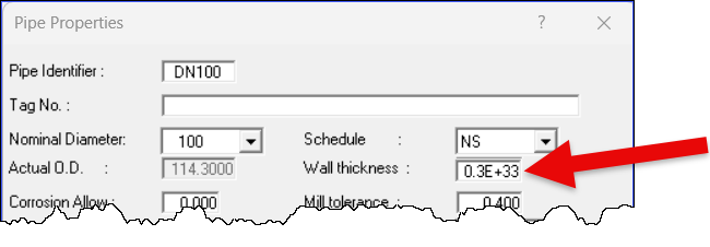

Suggestion #2:
One or more model input settings are wrong.
Certain fields must have specific data or a certain format. However, in some instances users have found a way around programming checks/limits. Typical issues are with values in dialog field:
Review all data by opening a dialog, and using the keyboard tab key to tab through the entire dialog to the end. Be sure to check to see that each value is correct for the setting. If a message is displayed while tabbing through, fix the data entry and continue.
Example:
a. Open PipeID dialog, while tabbing through the dialog, the following error appeared : Error : E31-15: Zero or negative value is not allowed. User was able to enter a -ve value in a setting that does not allow it. After correctly entering the data, the results database can be viewed.
