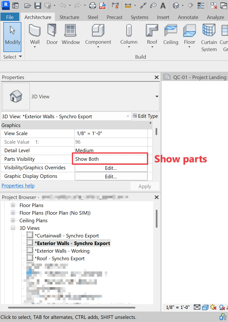

  • If you are to export Parts, make sure to set Part Visibility of the view to "Show Parts"

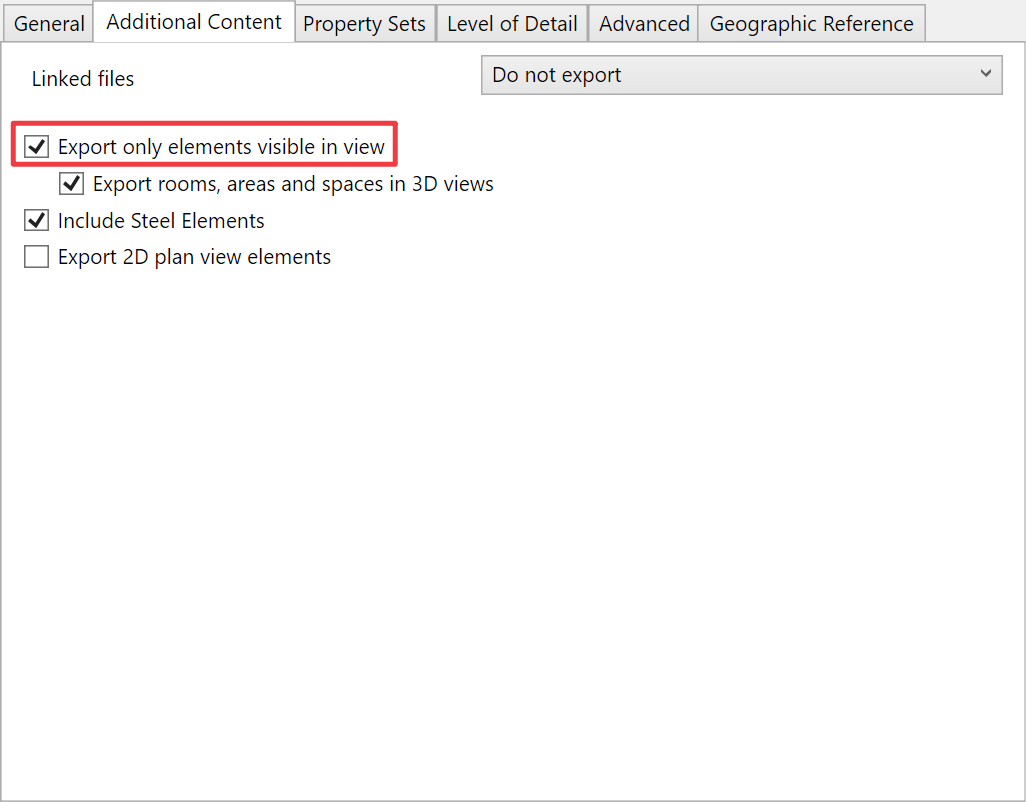

  • Go to File > Export > IFC
  • As IFC Export Options shows up, click “Modify setup …”
  • Go to Additional Content > Check “Export only elements visible in view”

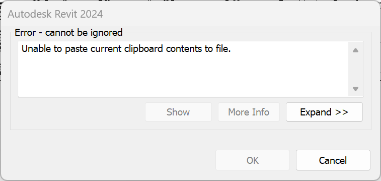

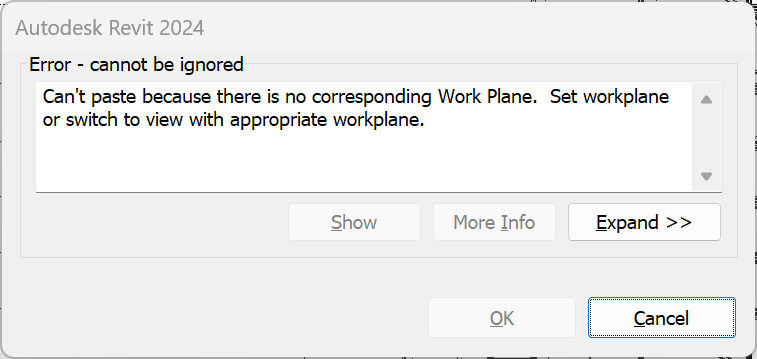

  • You may encounter error messages like these:
A screenshot of a computerAI-generated content may be incorrect.  A screenshot of a computerAI-generated content may be incorrect.
       This is due to the fact that the constraint elements are not visible in this view. You may try making the constraint elements visible or replace them with work planes; otherwise, we would recommend Option 1.

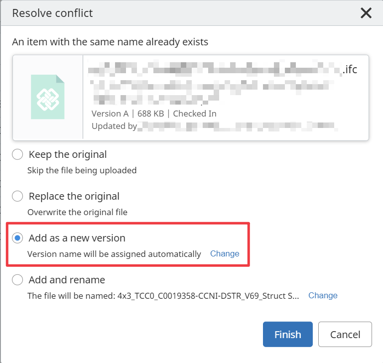

Step 5 – Update Model Changes
  • If any changes to the models occur, re-export and upload the modified model files to the same location without changing the file names and create a new version (See this article for Working with Document Versions).
