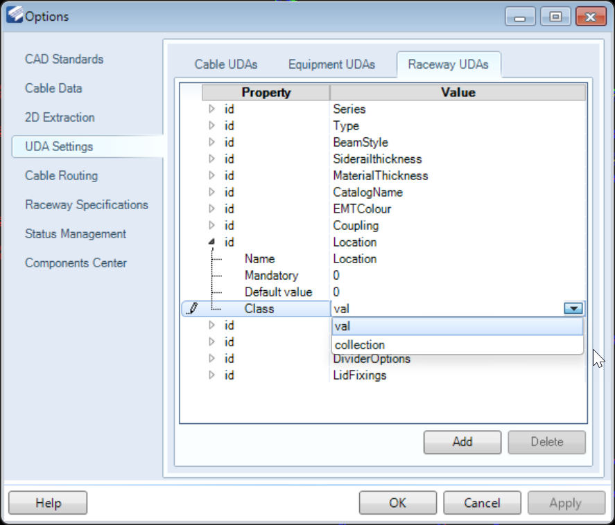

Configure “Location” Raceway UDA
  1. Select Manage > Options > UDA Settings > Raceway UDAs.
  2. Expand the “Location” property and select the “Class” picklist.  A screenshot of a computerAI-generated content may be incorrect.
    1. If you want to predefine a list of possible values you can set class to “Collection.” Just be aware that you will have to enter the possible values into your raceway catalogs in a later step.
    2. If you want to be able to freely enter any text into this property set the class to “val.”
  3. If you want to set a default value that will get used you can enter that into the “Default value” property.
  4. If you want to require the property to have a value you can set the “Mandatory” picklist to 1.

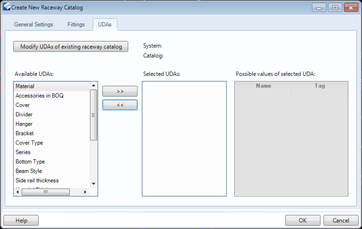

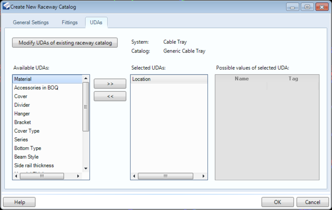

Add the "Location" property to your Raceway Systems

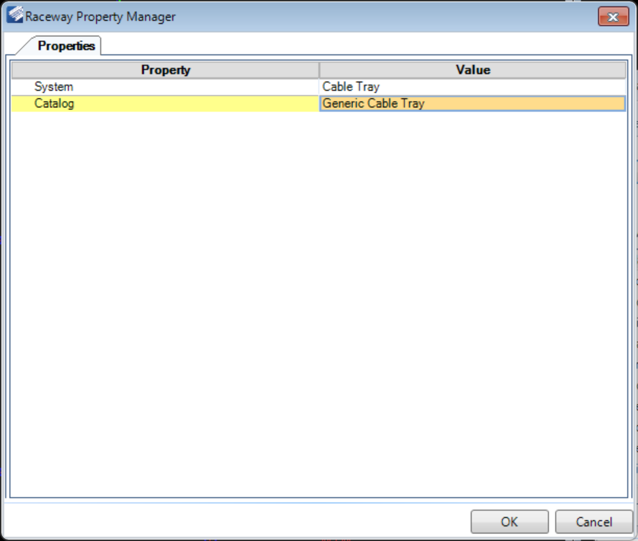

  1. Select Manage > Raceway Catalog Creation > UDAs A screenshot of a computerAI-generated content may be incorrect.
  2. Select the Modify UDAs of existing raceway catalog button. A screenshot of a computerAI-generated content may be incorrect.
  3. Select the raceway system you want to add the “Location” property to. In this example we will choose “Cable Tray” and then select the “Generic Cable Tray” catalog and click OK.
  4. From the “Available UDAs” list select the “Location” property and click the >> button to add it to the selected catalog. A screenshot of a computerAI-generated content may be incorrect.
  5. If you previously configured the “Location” property to use the class “val” the “Possible values of selected UDA” list will be grayed out as shown above.  If, however, you set it to use “Collection” you will be able to enter the list of possible values you want.
    1. Enter a “Name” of the location that you want to use (i.e. 101).
    2. Enter a “Tag” that matches the “Name” property (i.e. 101).
    3. Repeat steps 5a and 5b for each location in your project.
  6. Click OK to save the updates.
  7. Repeat steps 2-6 for each raceway system and catalog that you will use on your project.

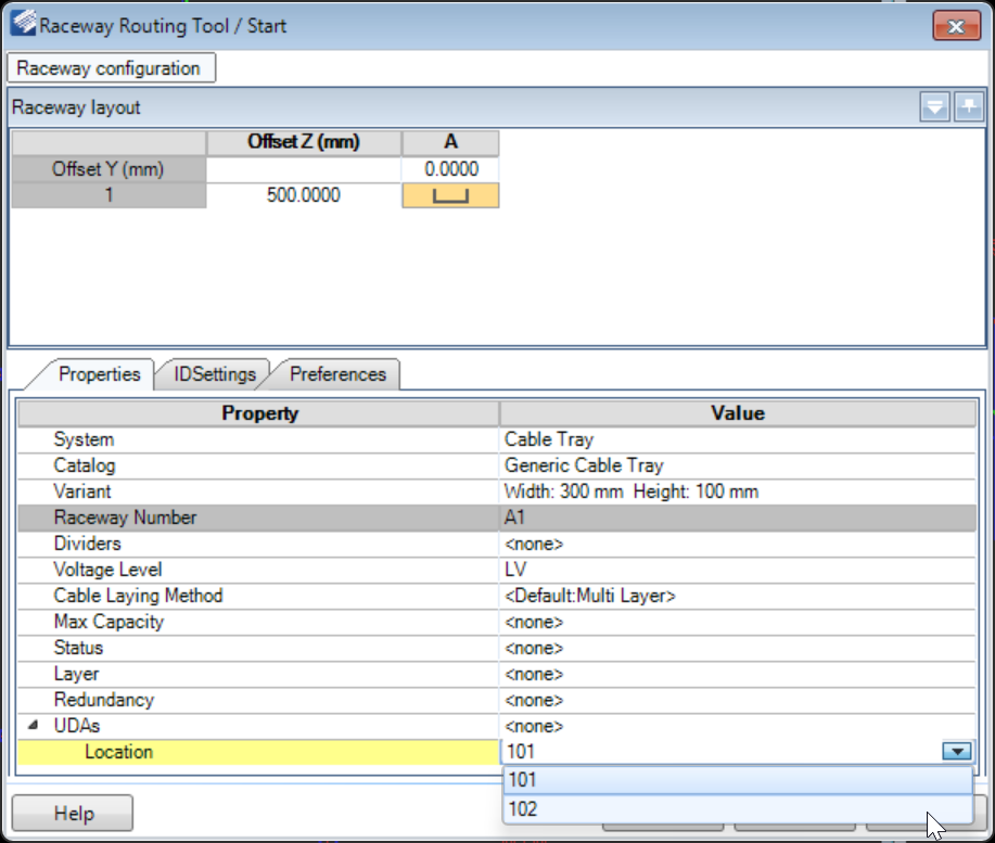

Route Raceways with the “Location” property
  1. Select the Raceway > Raceway Router tool.
  2. Select the Raceway system and catalog you modified to include the “Location” property.
  3. Expand the “UDAs” entry at the bottom of the Properties tab.
  4. Enter or select a value for the “Location” property A screenshot of a computerAI-generated content may be incorrect.
  5. Click the Route button and create a raceway route in the model.

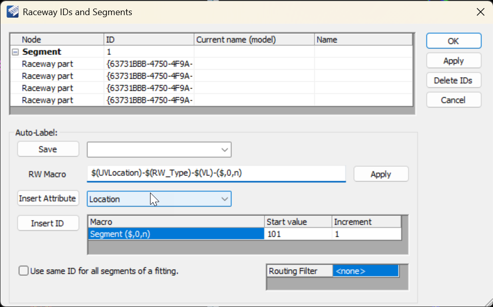

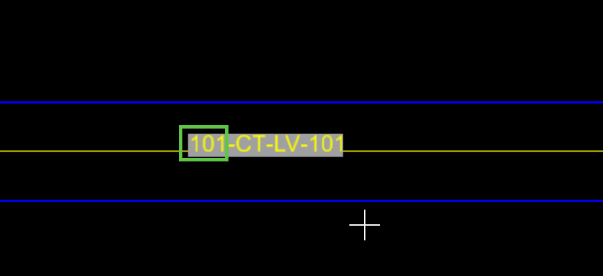

Include the "Location" property in your Raceway IDs
  1. Select the Raceway > Raceway IDs tool.
  2. Right click and choose one of the selection methods to select one of the raceway systems in your model that had a location specified for it.
  3. Select the “Location” property from the Attributes List and click the Insert Attribute button to add it to the RW macro as shown: A screenshot of a computerAI-generated content may be incorrect.
  4. Click OK to apply the raceway IDs. The Location property value should be included in the raceway IDs like this: A screenshot of a computerAI-generated content may be incorrect.

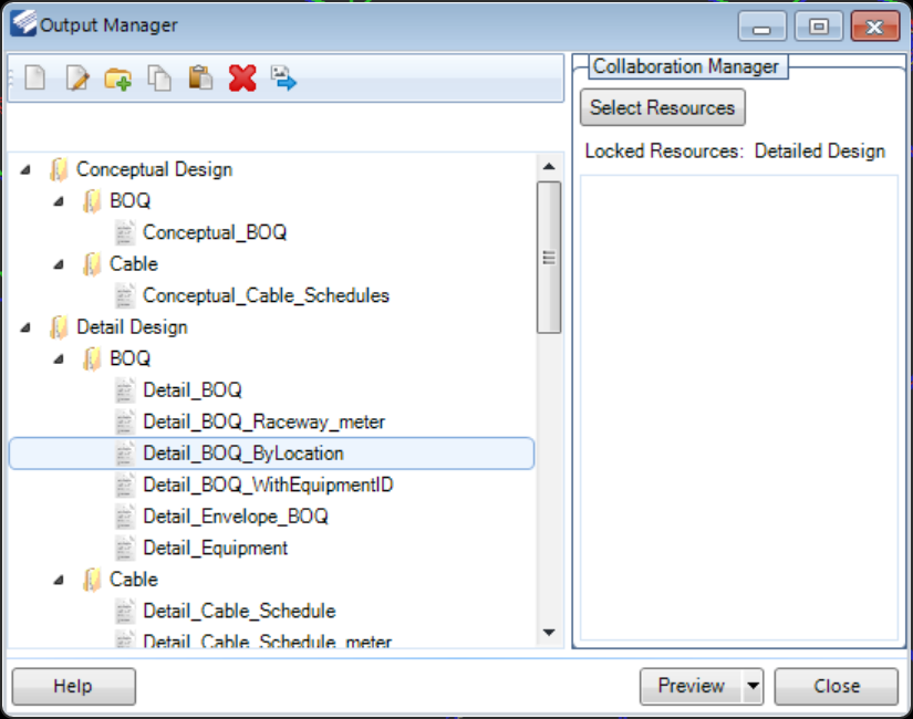

Create a Bill of Quantity report Grouped by Location
  1. Select the Output > Output Manager tool.
  2. Expand the Detailed Design > BOQ folder and select the Detail_BOQ_ByLocation report. A screenshot of a computerAI-generated content may be incorrect.
  3. Click the Select Resources button and select the required resources, right click and select Request Lock from the menu. A screenshot of a computerAI-generated content may be incorrect.
Click OK to close the Collaboration manager:

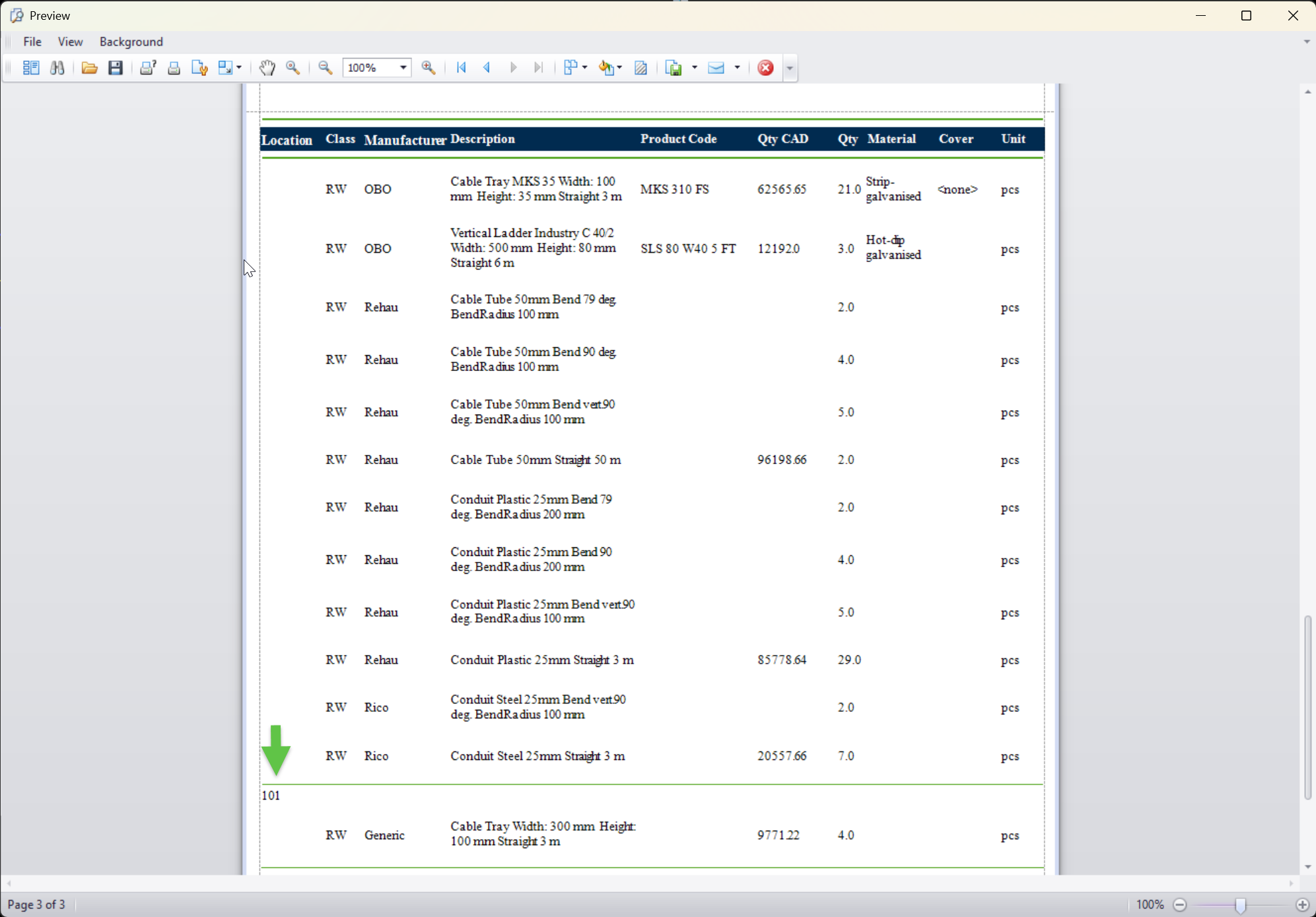

  1. Click the Preview button to display the report which should be grouped by the Location property as shown: A screenshot of a computerAI-generated content may be incorrect.
NOTE: If you want to create separate reports for each location you can customize the report template to include a filter on the Location property.
