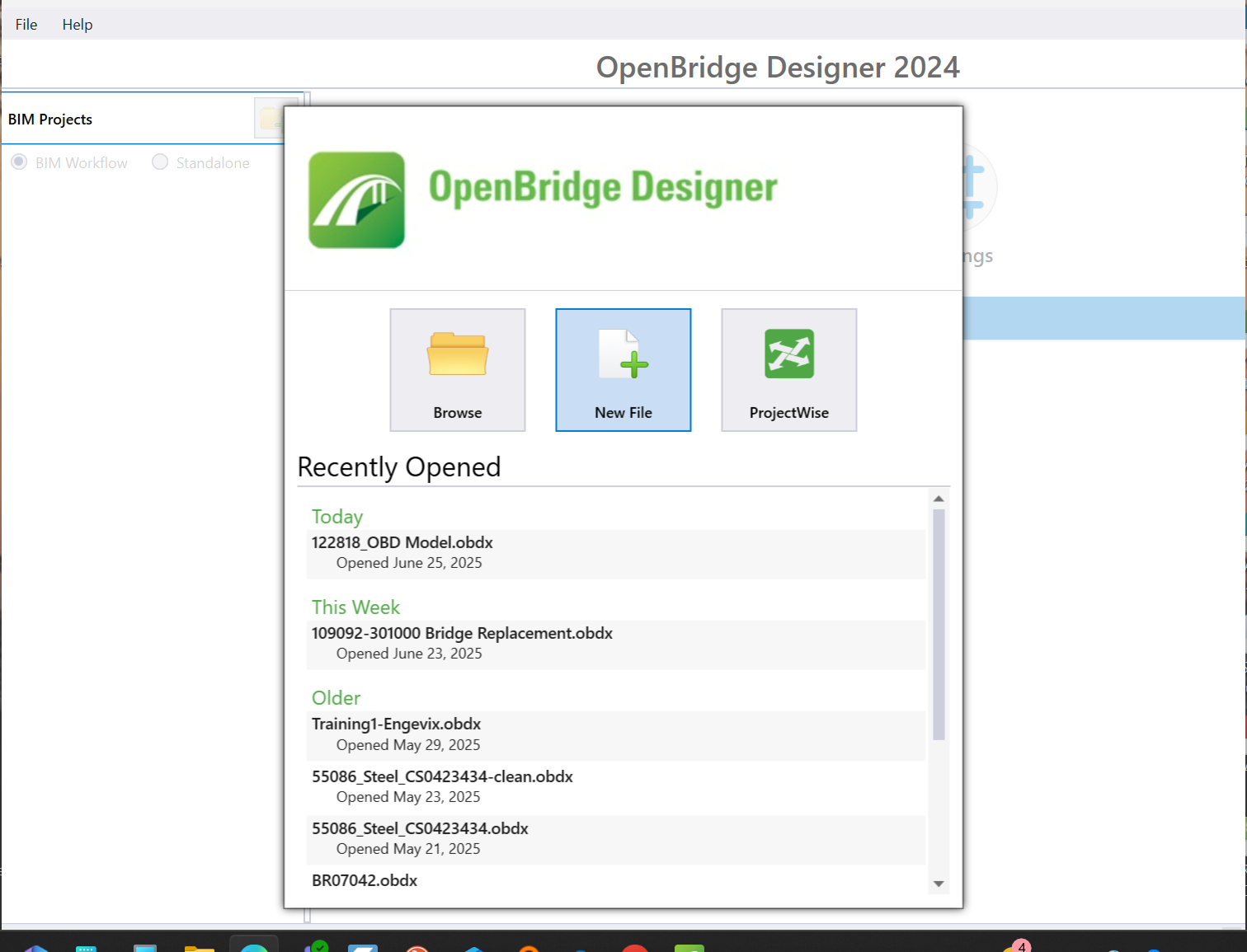

1. Access OBD
 2. Create a New File, and save the .obdx file with a name in the project folder location.

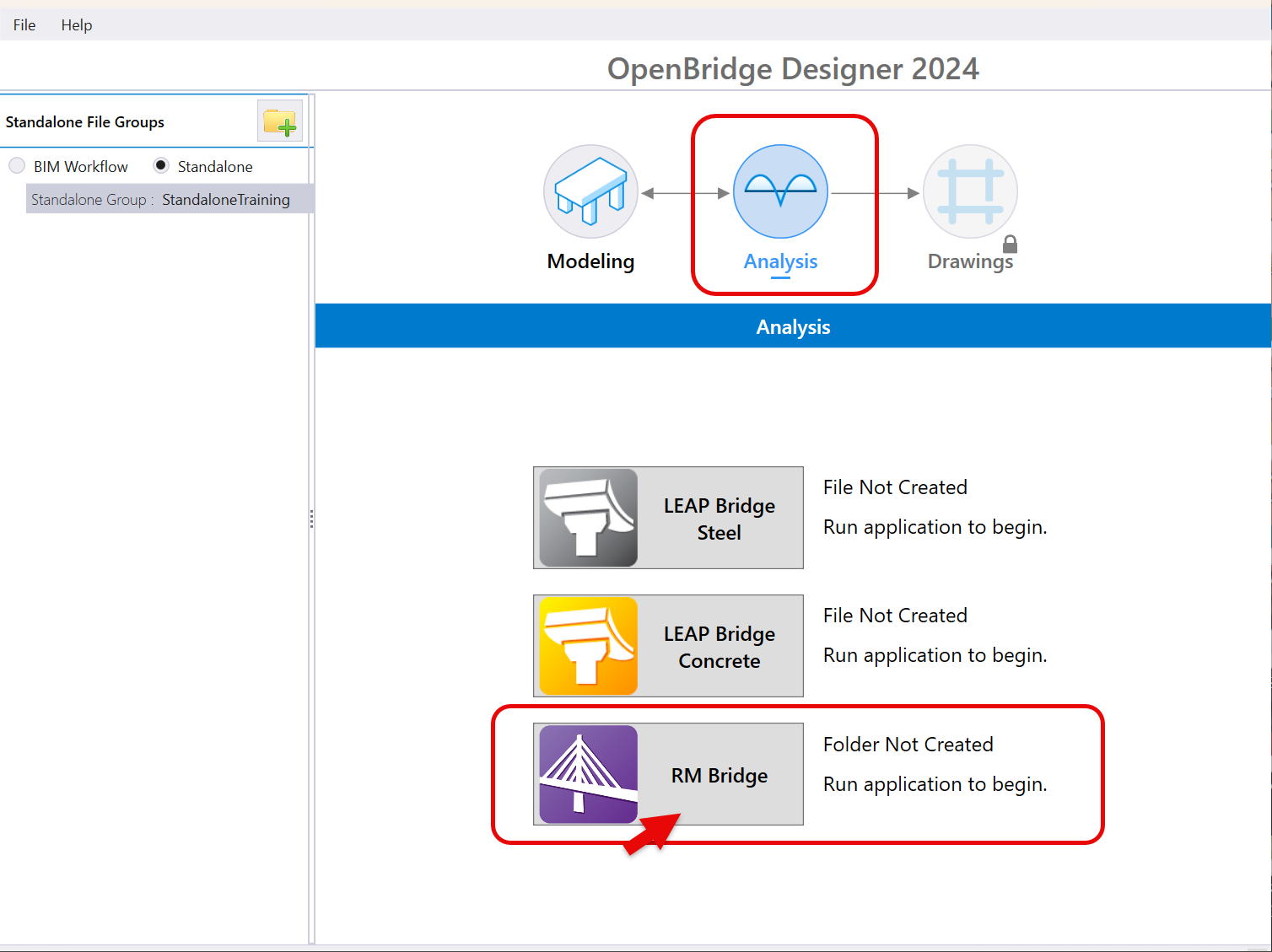

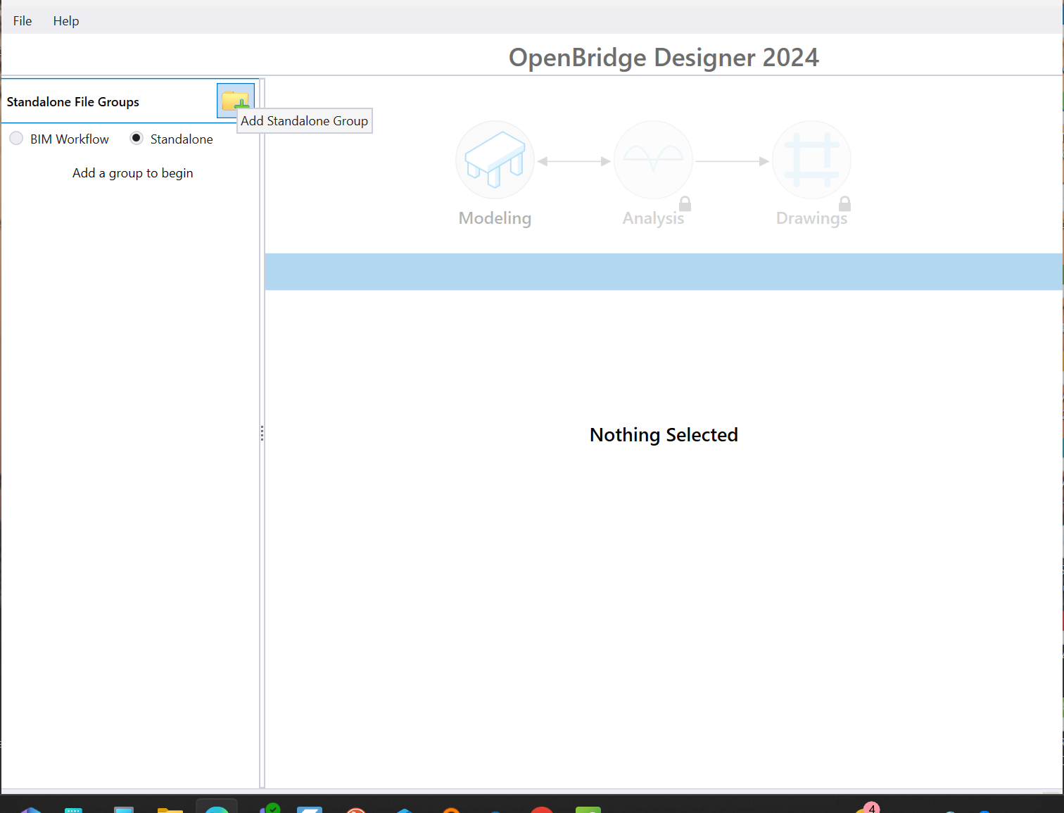

3. Add a Standalone/BIM Workflow group inside OBD (initially, we suggest Standalone for a disconnected project between Modeling and Analysis)
4. Select the Group, then click on the Analysis Tab and select/click on the RM Bridge icon/name to load the application.

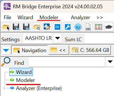

Note: OBD is the acronym for OpenBridge Designer, while OBM stands for OpenBridge Modeler, which is completely different from the RM Bridge portion Modeler that was previously called GP - Geometrical Preprocessor. The other RM Bridge module is known as Analyzer.
