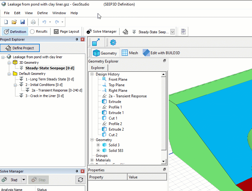

This article describes how to save your analysis files without the solution.  This will reduce the file size, making it easier to send to support staff for assistance.
How to Save Excluding Solution
  1. Launch GeoStudio.
  2. Choose the 'File' | 'Save As...' menu option.
  3. For the file type, choose 'GeoStudio - Excluding Solution'.
  4. Give the file an appropriate name.
  5. Attach the new file to your Support case.
