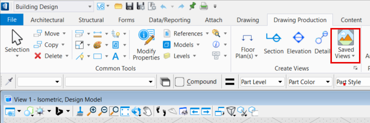

2. Open the Saved Views dialog box from Building Design > Drawing Production > Create Views > Saved Views.

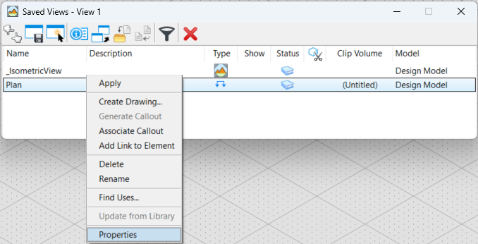

3. In the Saved Views dialog box, right-click on that save view from which the drawing has been created. Then click on 'Properties'.

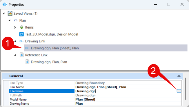

4. In the Properties panel, click on the Drawing Link showing previous name of the file. Then click on the three dots icon in the 'File Name' to browse to the location where the renamed drawing file has been kept and select it.

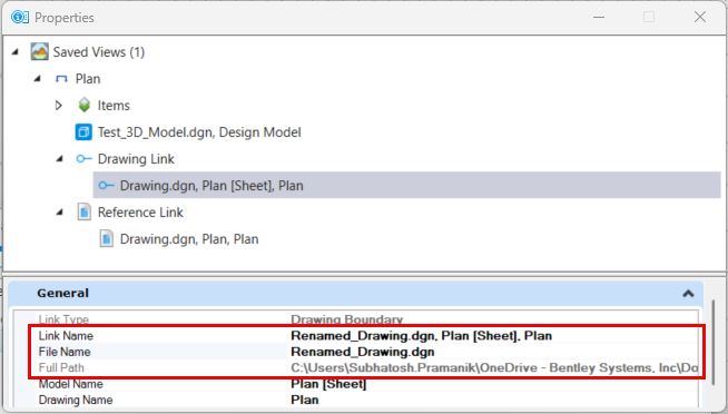

5. Once the 'File Name' field is modified, the 'Link Name' and 'Full Path' will change automatically.

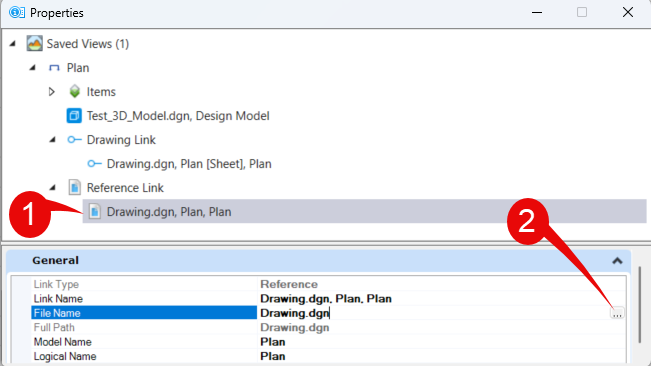

6. Now, select the Reference Link showing the previous name of the file and change the 'File Name' similarly as described in step 4.
7. Now, hover over the call out and you'll see that the 'Open Target' button has appeared and also the drawing file name has changed to reflect the correct name.
