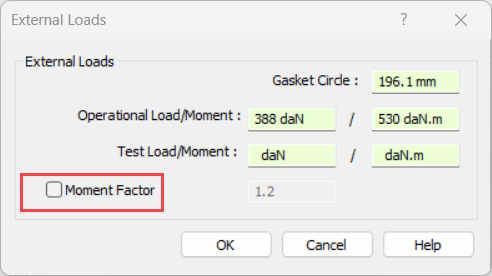

If the Moment Factor checkbox is unchecked, When using ASME design code, values​ defined by Table UG-44-1 (Div.1) / Table 4.16.12 (Div.2) are used.
Otherwise it is set to zero, a conservative value.
To view the details according to UG-44, navigate to Report > Summary > Summary of Forged Items > Standard Flanges > Evaluation of External Loads.

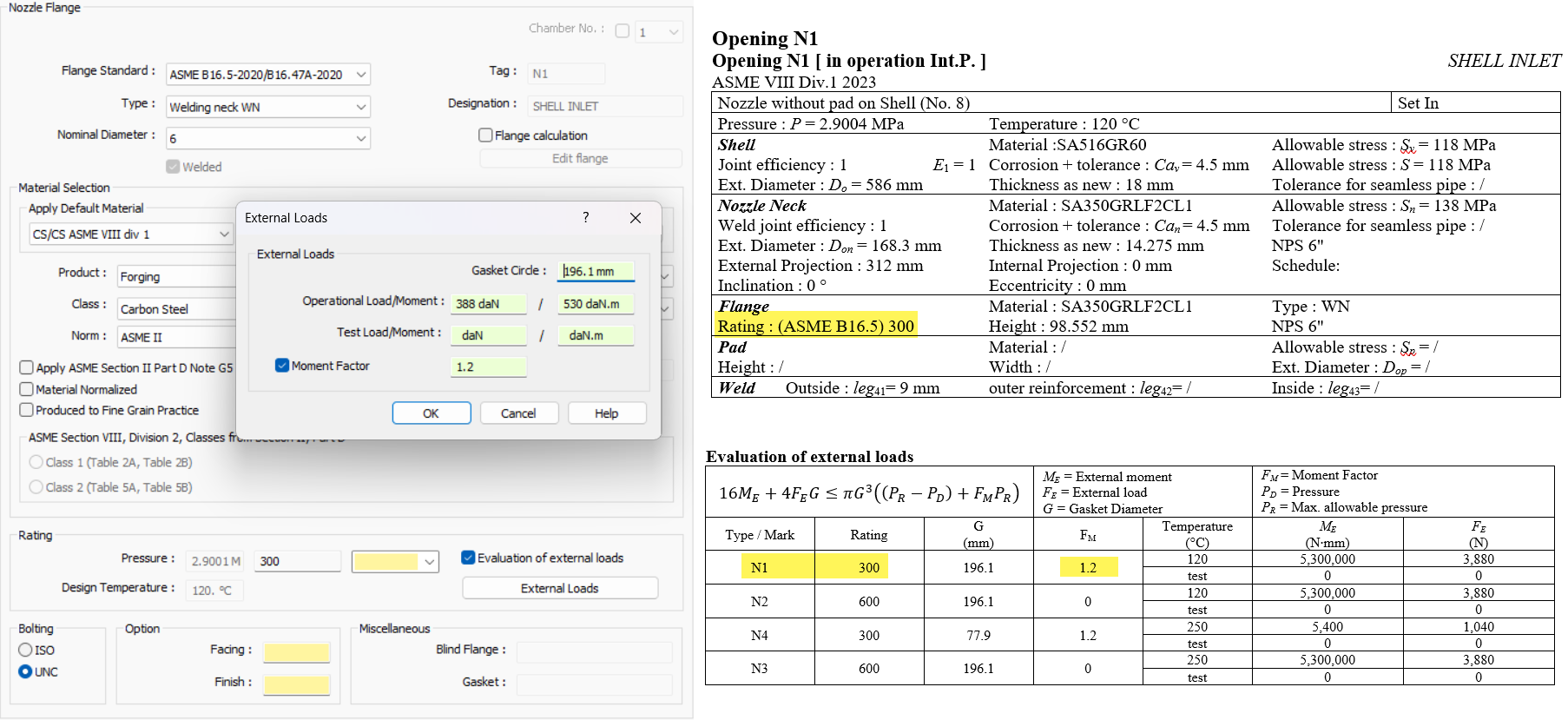

For Example 1:

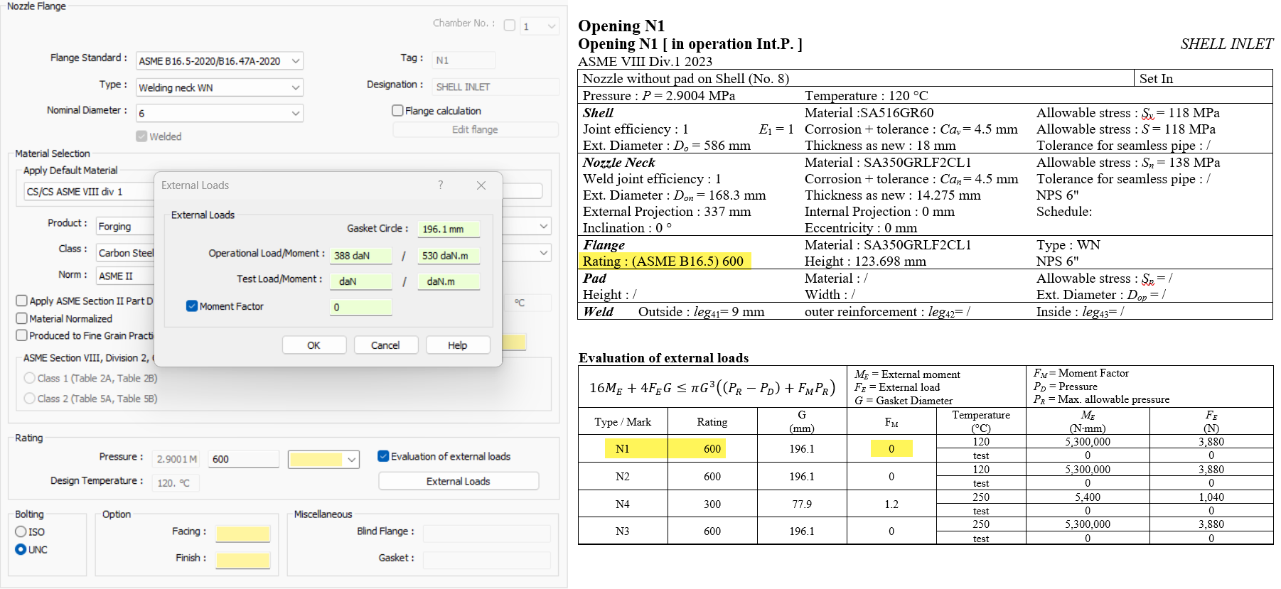

When we enter a user defined value of FM = 0 in Nozzle N1, the flange rating will be displayed as 600#.
Similarly when we enter user defined value of FM = 1.2  in Nozzle N1 we will get the flange rating of 300#.

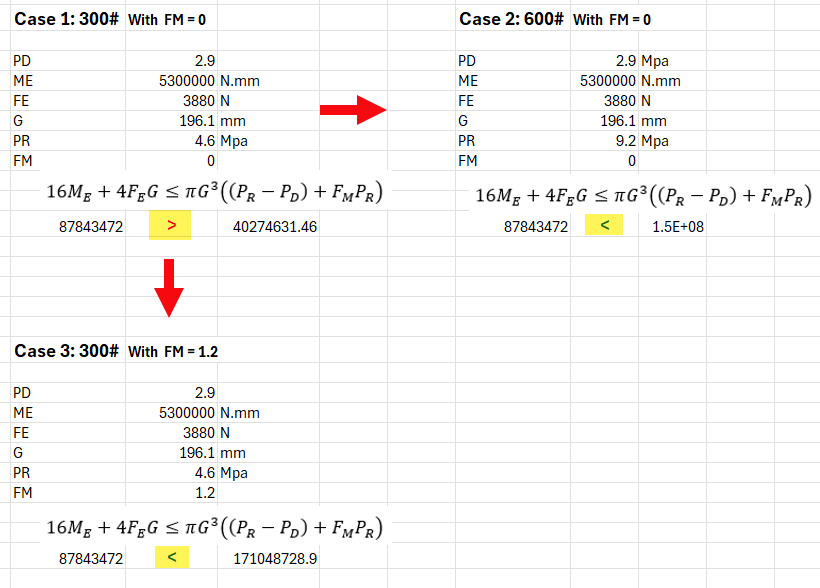

Below are the calculation details. We can understand the calculation through the following three cases.
  1. Case 1 : The flange rating for Nozzle N1 is 300# with a Moment Factor (FM) of 0, which does not meet the criteria specified in UG-44 (b).
  2. Case 2 : The software adjusts the rating to 600# with an FM of 0, satisfying the criteria in UG-44 (b).
  3. Case 3 : Adding a Moment Factor value of 1.2 to the 300# rating also meets the criteria outlined in UG-44 (b).
